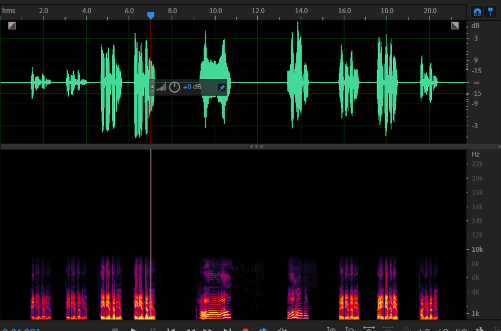

Hello, I'm pretty new to Audition so hoping this is an easy fix. My spectral frequency peaks are "cut off" at about 10k Hz. How do I adjust my settings so that this doesn't happen? I'm recording in 48000Hz, mono, 16 bit depth, and saving as .wav.

Inevitable questions: what are you recording? Is there actually any frequency above about 10kHz in your source audio? How are you recording these sounds, mic plugged into your computer, or via an audio interface? What mic are you using?
Your record settings which you list are fundamentally fine so, since Audition faithfully records exactly what it is given any problem must be occuring in the signal chain before the audio reaches Audition.

Being mono or stereo makes no difference. If you record a mono mic onto two channels, you're just wasting space on your hard disk, because all you've done is stored an identical signal twice.
If you record a male voice in a quiet space using a dynamic mic, then the response above, where most of the energy is in the 200Hz - 4kHz range, is going to be correct; the energy falls off above this. Okay, I wouldn't expect such a sharp fall-off, but there really isn't going to be any signal above 10kHz that will add any more clarity.
What we don't know about your recording though is, er, anything... What mic, what preamp, what sample rate, what processing did you do, what format did you save the result in, what the acoustic conditions are, etc. So beyond a generalisation, we can't really say too much about what ought to be there. Miracles we can usually do immediately, but the impossible takes a little longer!

Thank you for your response and providing me with additional information about the relationship between single microphone recording in pseudo-stereo and disk space usage. I'm understanding that you're using an M1 chip Mac mini, SHURE SM7B + iD4, and there are no effects plugins loaded within the Audition host. The sample rate is set to 48kHz with a 32-bit floating-point depth. While the audio above 10kHz doesn't have a significant impact on the sound quality, you've noticed that when using other hosts like Logic Pro in the same hardware setup, there is no occurrence of the frequencies above 10kHz being muted. Additionally, when recording with Audition, slight plosives are muted, resulting in missing initial consonants (e.g., the "t" sound in words like "touch"). When intentionally blowing into the microphone to create a strong plosive effect, the recorded audio appears as a nearly straight line without any waveform.

Thank you for your response, and it also gave me a better understanding of the relationship between single-microphone recording in pseudo-stereo and disk space usage. I am using an M1 chip Mac mini with SHURE SM7B + iD4, and I haven't loaded any effects plugins within the Audition host. The sample rate is 48kHz, and the bit depth is 32-bit floating-point.
Although the audio above 10kHz doesn't have a significant impact on the sound quality, I have noticed that when I use other hosts like Logic Pro in the same hardware setup, I don't encounter a situation where frequencies above 10kHz are muted. Additionally, when recording with Audition, slight plosives are muted, resulting in the absence of initial consonants (such as the "t" sound in words starting with "touch"). Moreover, when I blow forcefully into the microphone to create an exaggerated plosive effect, the recorded audio appears as a nearly flat line without any visible waveform.

After my efforts, I finally found the solution to this problem. The issue was with the microphone mode in Mac OS. When the microphone mode is enabled, you need to choose between the Standard mode or Voice Enhancer mode. By simply accessing this option and selecting the Standard mode or turning off the microphone mode, the problem of frequencies above 10kHz being muted can be resolved.
