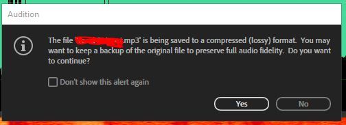

No - you haven't edited an MP3; You've edited a wav file. If you tell it to 'save as' a wav, then it won't encode anything. But if you tell it just to save, and you have the warning system turned on, then you get this:
And this is because, despite what it says on the file name, it's not an MP3 at this point. Personally I think that this is a little naughty of Adobe - it should make it clear that the file open on the screen is not an MP3.  What it should say is that the file will be re-encoded to an MP3 if you hit Save - and I have to say that this fools a lot of people, who don't realise the implications of the statement as it stands. The 'backup' they are talking about you get when you use the Save As option - and that's the one that saves the file as it currently is. As for whether you can hear the artifacts - that depends very much on the material and save rate; you are far less likely to hear it if it's sound effects.
But that's not all. If you do a Save at this point, you'll rencode that file to an MP3. But what remains on the screen isn't the MP3 you think you've just saved. If you want to hear your freshly-saved MP3, you have to re-open it, whereupon it will be decoded - again. The reason for this is that Adobe want to retain the option to let you save it uncompressed for as long as possible, and to do this the wav version has to be retained and visible.
It's fine to have this convoluted system, but only if it's explained properly, and unfortunately I don't think it is at present - or come to that, has ever been.
