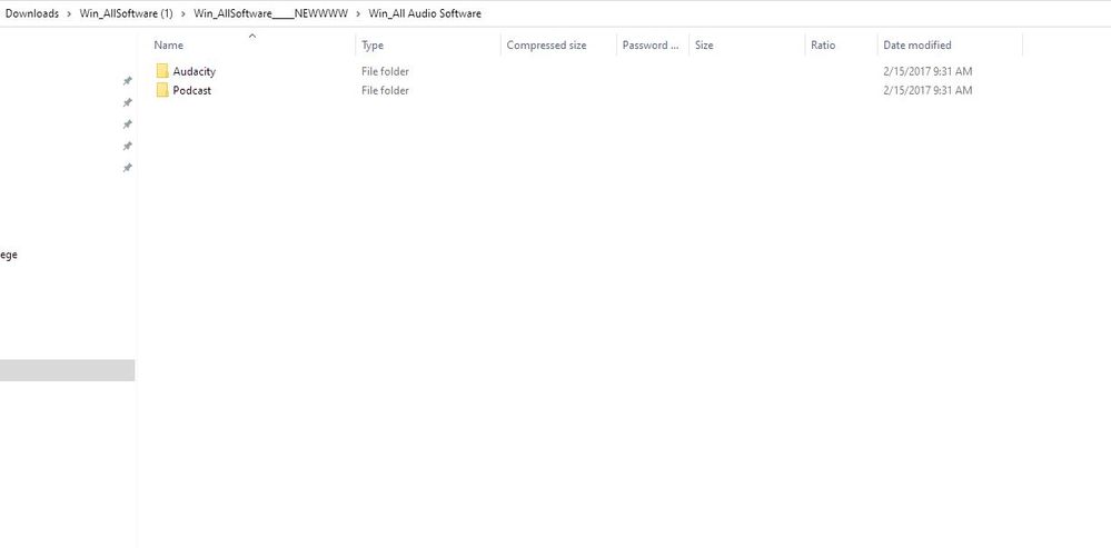

SteveG, thank you.
I've attached more images to help illustrate my confusion.
There are only 2 options other than the ASIO4All driver download.
I've downloaded "All software" and opening the zip file brings me to the above choices: Audacity or Podcast. None of these have a recognizable 64-bit driver package.
Apr 14, 2020 Apr 14, 2020
I did a bit of checking - seems that there's a lot of discontent about this. Behringer removed the original ASIO driver and replaced it with the ASIO4ALL one which is rather less satisfactory - mainly because it's not really a driver but an interface to the 'normal' Windows driver. Somebody's done some research though and found the original driver that was removed, and posted it elsewhere. Now I can't tell you absolutely that you should try this - but I have to say that I can't see what harm it will do either. Anyway, the link to it is here: Behringer 64-bit ASIO driver If it works okay, it will be a lot better than what looks like a half-working ASIO4ALL one.
