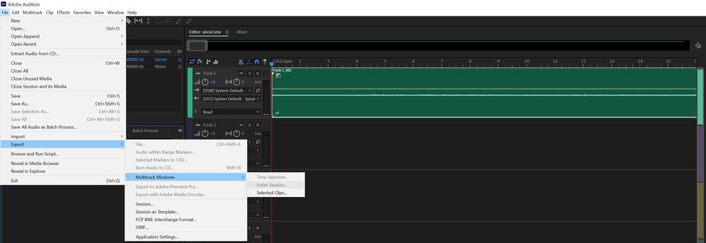

I am having an issue i can no longer today export my entire mixdown as  mp3.
When i try the option entire session is greyed out. Note i am in multitrack

You haven't said whether this is on a PC or a Mac. There have been a couple of reports of this happening on Macs but none on PCs, and certainly here on a PC the export options are correctly displayed in Multitrack. The other complaints are also about exactly the same option being missing.
There are a few things to try: Try copying the files into a new session and see if the same thing happens - this is just an attempt to find out whether a corrupted session file is behind this (we've asked others to do this but not had any definitive response from them). If it's just the same, then it's possible that a corrupted Preferences file is to blame. Unfortunately the cure for this will remove any custom settings you've made, but it's easy to implement - you just stop Audition and restart it with the Shift key held down. The most comprehensive way of resetting Audition is to clear out your installation using the CC cleaner app instead of the Microsoft uninstaller and then reinstalling, but that really is a last-ditch solution.
One of the problems here is that if this was a genuine bug as such, there would be loads of complaints about it - and apart from a few Mac ones, there haven't been. This makes it rather hard to determine whether it actually is one or not. If none of the above works for you, it might well be worth reporting this on the Audition Beta forum, where the developers are far more likely to see it, and perhaps respond...

Replying to myself because I can't edit I guess... I found my issue. I noticed my Master Mix had no audio going through it. Checked my "out" settings on my tracks and they were all set to to system default output - Once I switched them to Mix I was then able to Multi Track Mixdown,Export, Entire Session. Took me an hour! uhg...

Replying direct to the poster. Change your "out" on each track to MIX. This should allow you to export entire session. I just figured it out for myself.

Hello
You have a screenshot
Community Beginner ,
Nov 06, 2022 Nov 06, 2022
Change that setting to Mix. That should do it if this was indeed your screen.
Whilst I think you're correct about the routing, it's important to note that it may not be 'Mix' that it needs to be set to. What it should be set to is whatever the Master channel has been named as. Rather unhelpfully, the default templates don't all have it with the same name...
