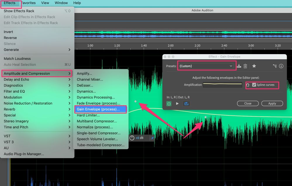

Also a pic showing how:
I would however recommend you work in the track editor which is non destructive and you can then
revisit your edits before any export of an altered COPY.
Doing this in the waveform editor IS destructive and will permanently affect the file.
So, work on a COPY, not the original.
Community Expert , Jul 03, 2022 Jul 03, 2022
Ah, you are introducing this by moving the default gain line down.
Please see this:
I've recreated something similar with a similar gain envelope shape.
I added the effect and choose default under presets in case there was a previous custom one in the effect.
The default creates a yellow envelope line as shown by the red arrow.
Do not move this down to the red line shown as you have done.
Where the default paleces the line has neither gain or attentuation.
Move your line up for gain and NOT dow
Please see this:
Move your line up for gain and NOT down which attenuates.
I see that you are working in the waveform view.
By using multitrack you can experiment until you get it right
Best regards, Euan.
