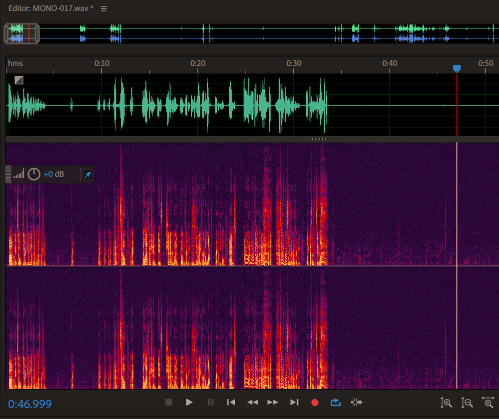

I am editing some audio and trying to use the match loudness function to bring the audio from -32 LUFS to -16 LUFS and when I do so, it amplifies a lot of the fuzz in the background that you could not hear in the original.
Here is a screenshot of my audio before running Match Loudness:

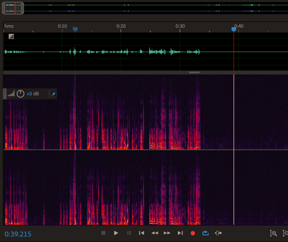

And here is a screenshot of my audio after:

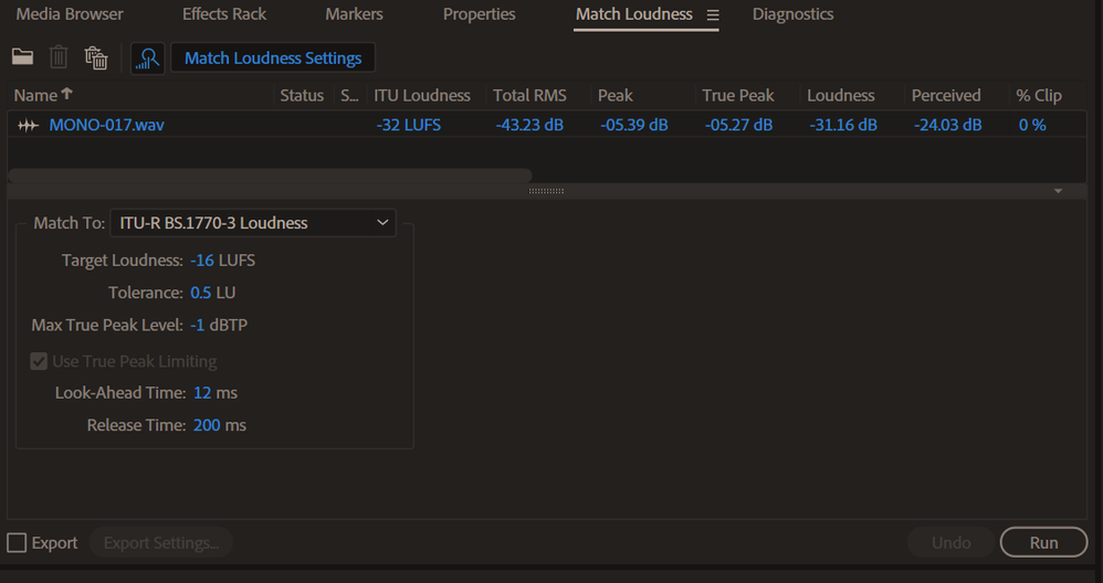

Here is a screenshot of my settings when I run Match Loudness also:

The noise is there anyway. If you amplify the signal by 16dB, you amplify the noise by the same amount. And anything else you do to the signal itself, like compression or limiting which would even the signals out, is going to make the dynamic range worse. And that's what we are looking at here - the dynamic range of the signal. And that isn't affected by the absolute level of it at all.
So if the noise rises to an unacceptable level, then the only thing you can do, as you've surmised, is to use Noise Reduction. This will leave the peaks of the signal alone, but lower the noise floor - thus increasing the dynamic range. Generally the thing to do initially is to normalize the signal to 0dB and then find out what the noise floor value is. Then make adjustments so that you keep the average level comfortable without loads of peaks. On your example, I found that Audition's DeNoise works surprisingly well, although like most NR, it's best run twice at a moderate setting. If you run it twice at 50%, that leaves you with a LUFS value of -15.64 and your side of the conversation at least, pretty clean.
