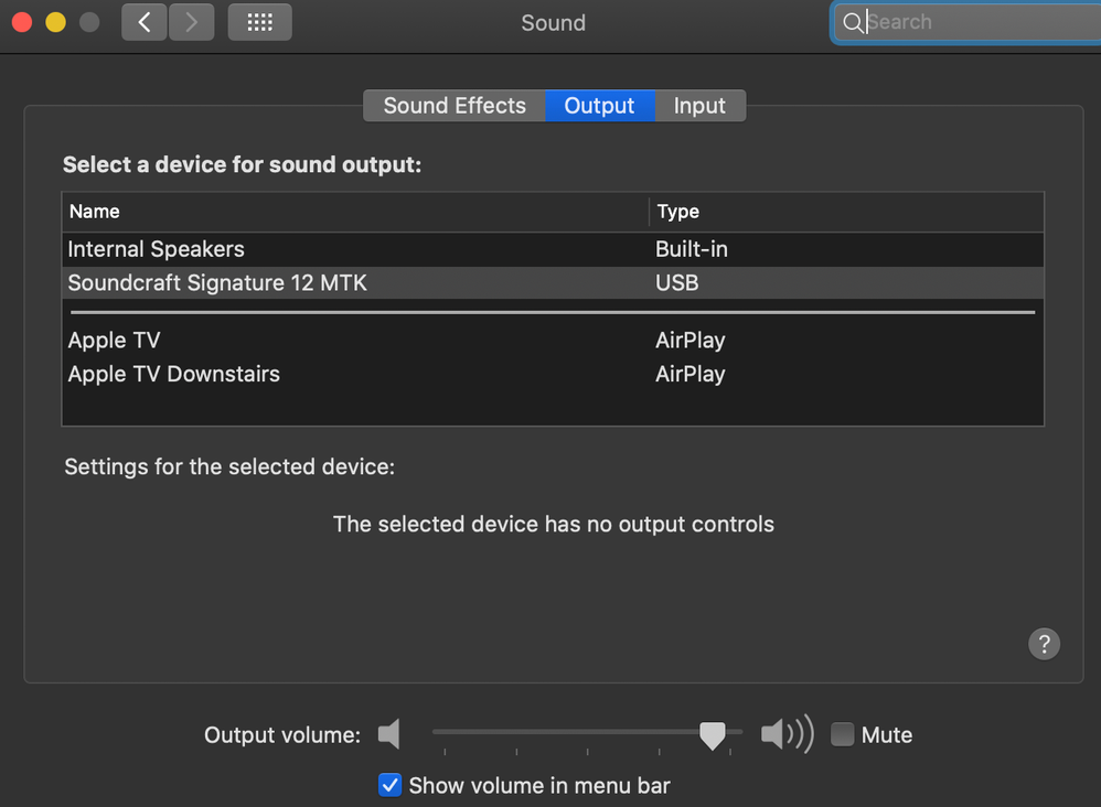

I recently updated my Au and for some reason, I lost all my settings and had to repopulate them. I was able to get more or less back to the same config but for some reason, I am unable to hear the audio when I am using Au to record my podcast. I can hear the sound in my mic since it is patched in directly from my mixing board, but I cannot hear any of the audio being sent through Au. Here is my current configuration:

6. I have checked all the settings in Au including Audio Mapping and Audio Hardware. All seem to be configured correctly.
7. I have checked my iMac audio/sound settings. All point to the Soundcraft as input/output and seem to be configured correctly.
8. All other audio functions correctly within my iMac.
In a nutshell, the visual levels in Au do move and the input is there. I just can't HEAR the audio as it is playing through Au. I arm each track to record but still no sound through headphones. I have also done a clean install of Au and again, repopulated the settings to no avail. I am at my wits end on this and will admit this is probably some mundane button I have failed to toggle that will give me the audio back. But I cannot seem to find it. Any help would be greatly appreciated!!! I've included screen shots of my settings to help. Screen Shot 2020-02-23 at 11.35.18 AM.pngScreen Shot 2020-02-23 at 11.35.28 AM.pngScreen Shot 2020-02-23 at 11.35.49 AM.pngScreen Shot 2020-02-23 at 11.35.59 AM.pngScreen Shot 2020-02-23 at 11.36.27 AM.pngScreen Shot 2020-02-23 at 11.36.37 AM.png

HEY MIKE!!!! I sent you an email to your personal email on this issue. You and I did a one on one session last year. You made some awesome presets for me!!! As far as the USB return buttons, I have them configured as I always have. The only one I needed to have enabled is the track with my iMac playing through. I enable Channel one and while I can then hear the music bed, I can't hear my main podcast mic on Channel one. If you want, reply to my email.
