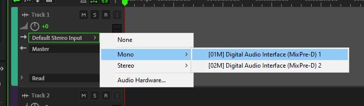

It's set up correctly using core audio - you only get ASIO if it's a PC - as in my assumption. The extra inputs will only be visible in the track controls, and that's where you have to select them:
That's my MixPre, but exactly the same thing should happen with your 4i4 - all four should be available there as mono inputs...

Yes, I noticed that I could select the other inputs there, but I still get no sound. I know the 4i4 is working cause i can tap in front of my microphone and i see it's taking the input as the gain lights up....but no audio comes out my speakers.
