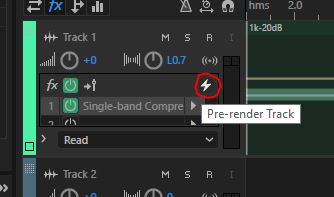

One thing you might want to try is pre-rendering (aka 'locking') tracks with intensive effects on them before doing your mixdown. This will pre-process the track, and potentially reduce the chances of these things happening.
