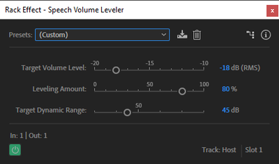

As I indicated in my email....
The problem is the Speech Volume Leveler settings
Essentially this is just a compressor and what you are doing with these settings is limiting the overall level to -18db and increasing the gain (levelling amount) by 80% (whatever that means)
The end affect is that the noise floor is being increased by a huge amount which is the noise you are hearing.
If you are going to use this effect you need to probably select the ‘careful’ or ‘soft’ preset but if it was me I would just use a compressor where the settings are more obvious (to me anyway).

Well, those are the default settings for the Speech Volume Leveler in the podcast template for both host and interview, and that is the exact reason that we do not recommend it to anybody! Similar things could be said about the effects applied in the Sound FX and Music bed - none of these are likely to be appropriate for the material used.
       Bottom line: DO NOT USE THE PODCAST TEMPLATE - EVER!
