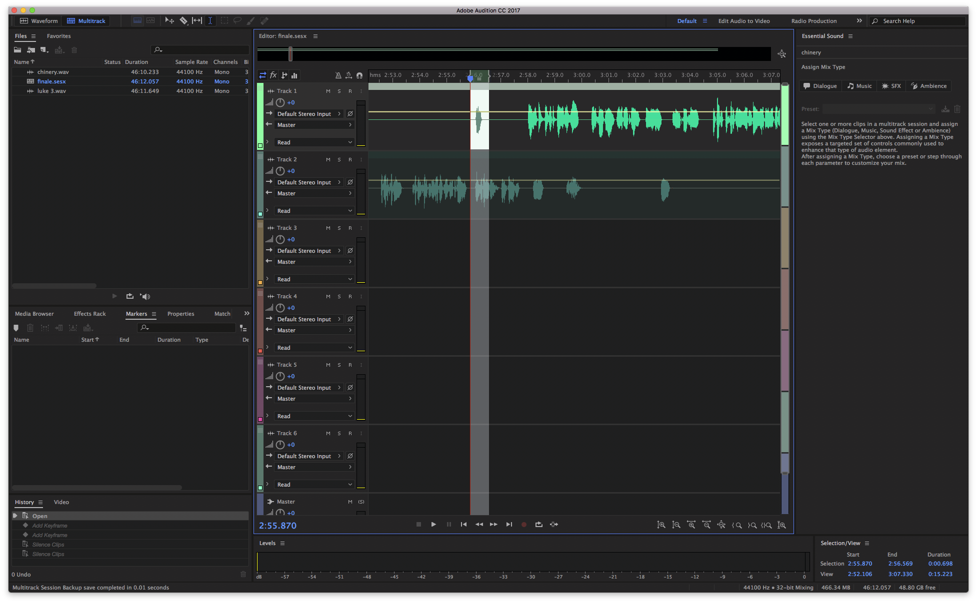

Track one (good behaviour) before:
Track one (good behaviour) after:
Track two (bad behaviour) before:
Track two (bad behaviour) after:

I can't think of any logical reason for that to happen. If you move the clip from the faulty track down to another one instead does the Silence Selected Clips in Time Selection work OK there?
