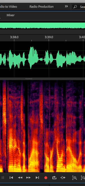

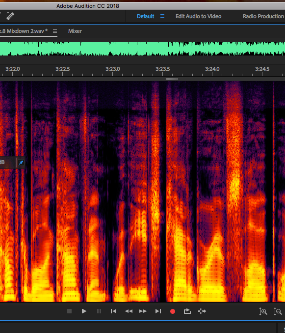

I've been using the Match Volume function to adjust my Total RMS and Peak Amplitude to fit the requirements. I notice how some of my source files display waveforms that have varying sizes and degrees of "fuzziness." I did use 3 different microphones in recording these files. My concern is that sometimes when I change the Total RMS then apply a Peak that the resulting waveform sometimes ends up looking like a SOLID BLOCK of sound -- like ALL the sound gets increased to a certain amount and then clipped back to fit the -3db Peak. The spectral waveform still looks the same though... And the sound still seems fine. ...Especially when listening through my (undamaged) laptop speaker. Also, the waveform seems to only be chopped on the top-side, not symmetrically limited. Weird!
I'm also wondering if these changes are destructive. Or can I keep adjusting the levels using various strategies until the result seems best?
Then there's workflow. If I start with a somewhat quieter file it might not have hardly any louder spikes so if I first apply the -3db Peak it maybe doesn't change much, then if I apply a change after that to Total RMS I might then end up with a lot of peaking and need to apply the Peak again...
Thanks for any thoughts on this... Or helpful links...
Here are screenshots of before and after.
Before at Peak -.7dB and Total RMS -29dB:
After has Peak -3dB, Total RMS -21dB. ...Shows a rather "solid" waveform with an assymmetric top side:
Here's an After shot that started as an even quieter waveform and ended up REALLY solid looking, also asymmetric. It fits the specs but LOOKS really weird to me:

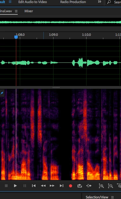

Here are some more Before and After's....

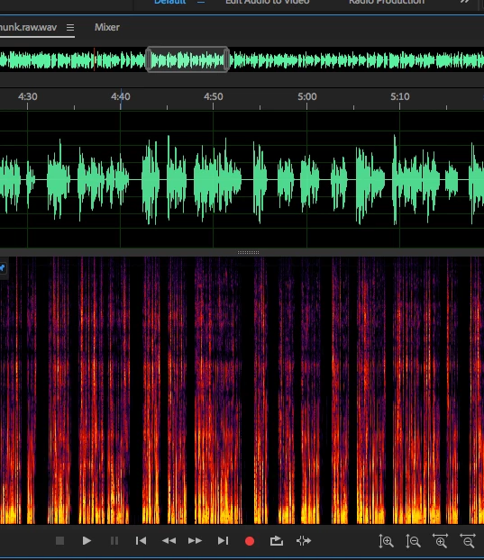

Here is an overly quiet file -- Peak -5db, Total RMS -31db:
Now I've increased the Total RMS to -17db:
Now I set the Peak to -3db -- and the Total RMS comes out at -20db. I note that this file didn't end up with as "solid" looking of a waveform as some of the others:

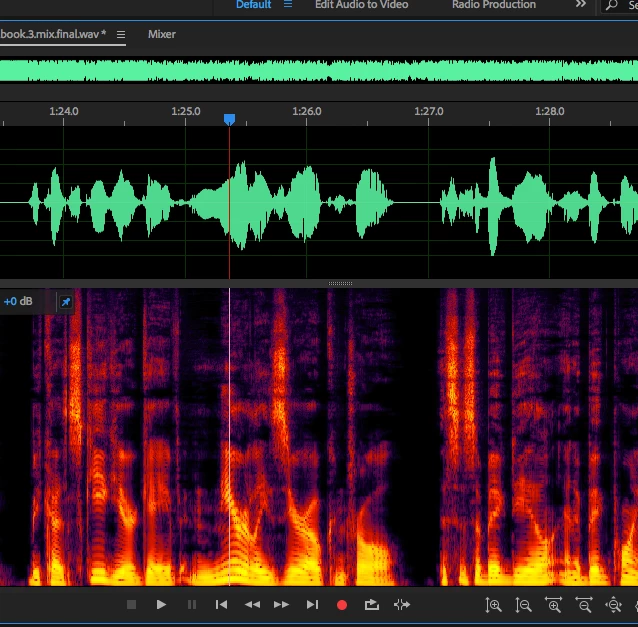

Now, here is a file where the waveform looks "normal" to me and it is within specs!
