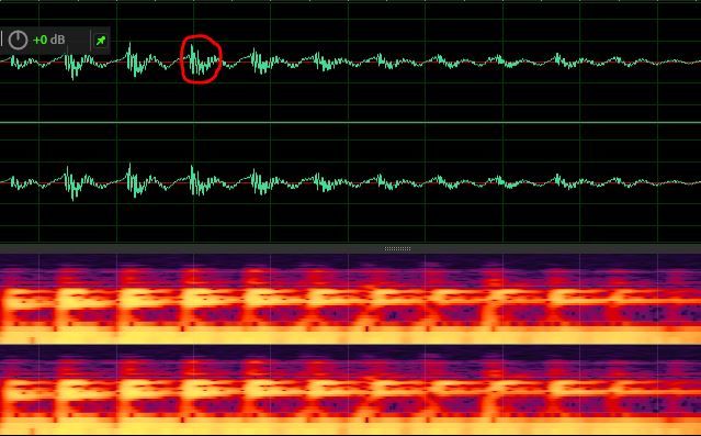

Need to see the original file, as well, to make a comparison. I can clearly see the blip on 'disaster' and it looks as though there's some sort of frequency-based error at the blip point (I've put a ring around it on one channel):
