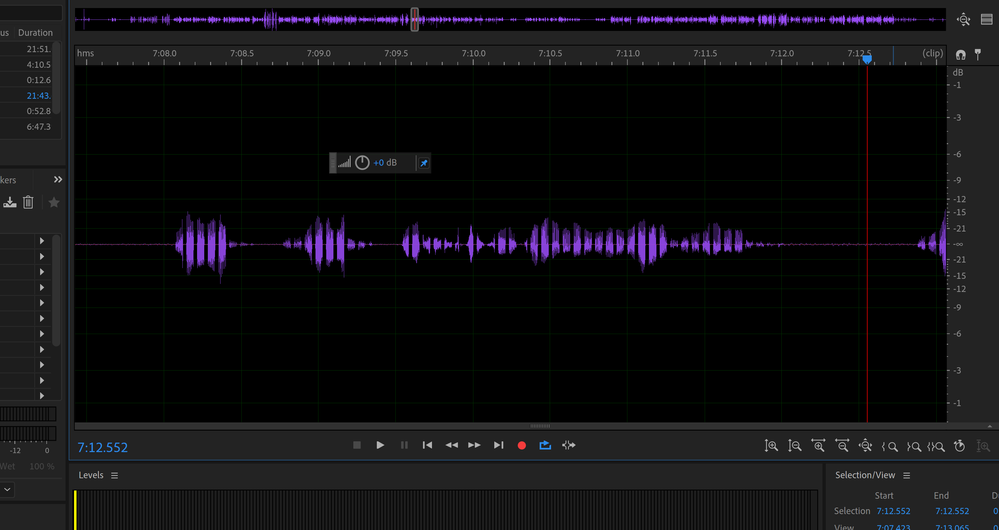

I'm not sure I know enough to navigate my way through process monitor. Here's an image of what happens after about 10 minutes, whether I'm recording or not. The waveform will suddenly become intercut, like this.  Screenshot 2020-08-21 17.50.10.png
Then, if I change the buffer size either up or down or restart Audition, it records normally again for about 10 minutes, then does the same thing.

Same symptoms, Mac and PC... Doesn't happen to other people (certainly not reported here, anyway)... Leaves buffer-sized gaps...
Yes I'm pretty sure it's a buffer issue of some sort. Go to Edit>Preferences>Media and Disk Cache and ideally create a separate folder on your HD for the primary temp file - the secondary isn't so important (I manage fine without one). Also whilst you're there, click on the 'clean' button in Shared Media Cache Files. Depending upon what you've been doing, that can easily get clagged up with stuff that really doesn't need to be there.
If none of that fixes anything, report back and I'll escalate it.
