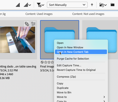

Then I went to each folder, right-clicked on the folder, and selected "Open in New Content Panel."

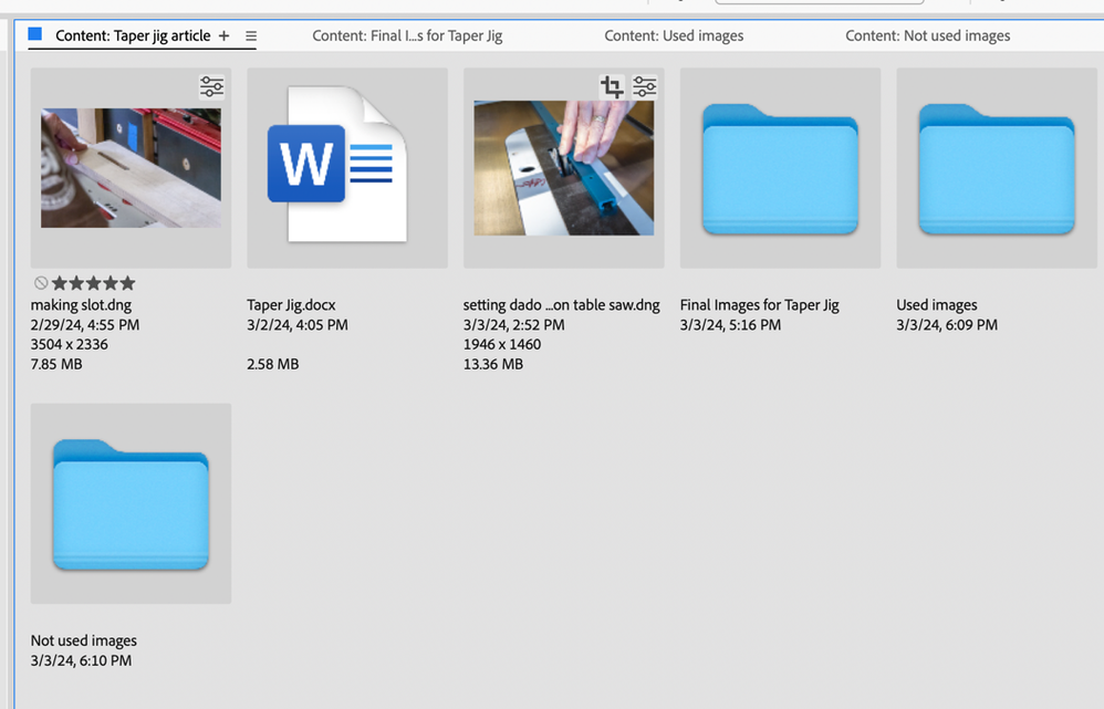

When I finished, my Content Panel looked like this:
 As you can see, there are very few images in the original folder right now becuase as I used them, I moved them into the proper folder. I did that by mousing down on the image(s) and draging the mouse over to the proper folder. I then held over that folder's name until that folder opened up. Then I moved the mouse (and the file(s) down over the conent region and then let go. The files were then moved to the proper folder.
