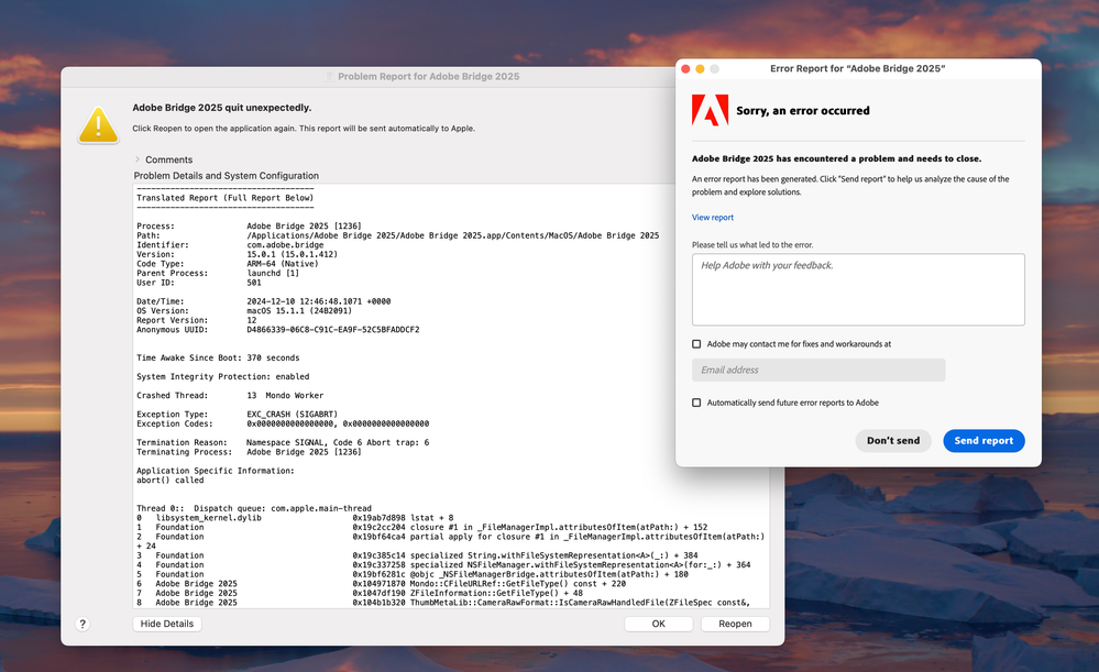

Hey Ashmit. I have Photoshop 26.1 so I dont think it is the beta.
System info:
- Sequoia 15.1.1
- Bridge 15.0.1.412
- Jpegs and mp4
I have attached some screen shots, when I try viewing the folder of the network the circle at the bottom of the window spins, then stops and the app crashes. When I first opened Brdige it mentioned something to do with the GPU., I clicked the learn more button on that web page it mentioned some issues with brdige and Apple Silcon and for me to install Rosetta. I have installed that view the terminal but its still crashing when i try to view a folder of jpegs.Screenshot 2024-12-10 at 12.46.38.pngScreenshot 2024-12-10 at 12.46.56.png
