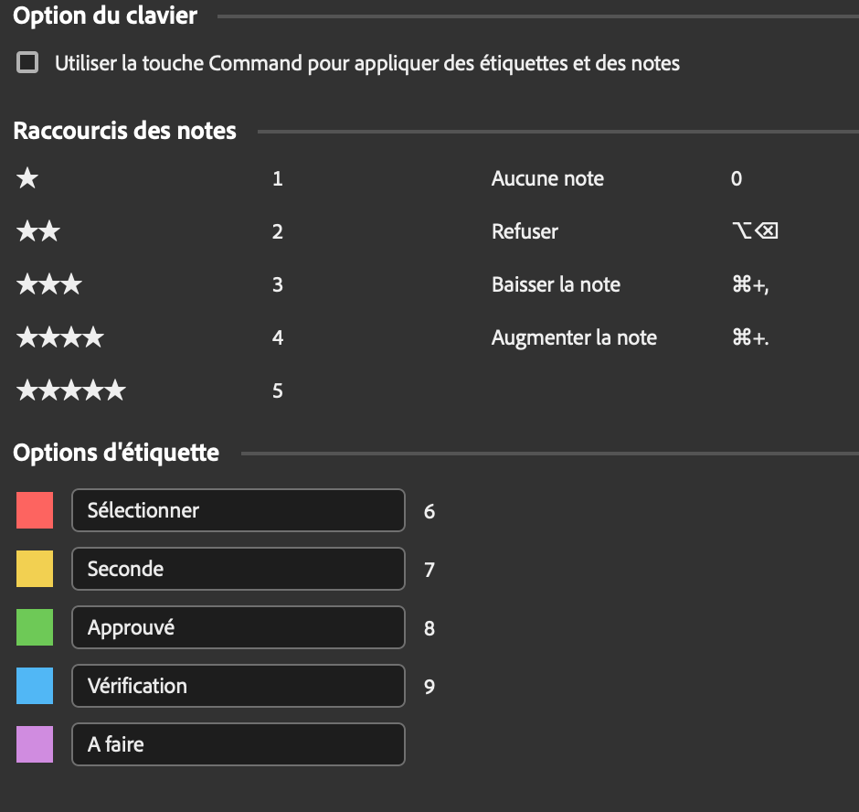

Thank you all for reporting the issue. We need your support to better investigate the issue.
Only for MAC users - Could you please do the following and confirm the result:
1. Open Bridge  (we are assuming your  system  keyboard layout is already set to Non English for  e.g. AZERTY)
2. Select an image
3. Try to apply the rating/label using keyboard shortcuts (either through cmd+<numeric> or only <numeric> key - Expectation is that this won't work
4. Now open Label Menu in topbar of Bridge
5. Please share  the screenshot of the keyboard shortcuts shown there
6. Now close the menu, select the image again and apply  label/rating using keyboard shortcut - Expectation is that  it should work.
It  would be really helpful if you can  share the results.

Adobe Employee ,
Dec 22, 2022 Dec 22, 2022
We have released a newer version of Adobe Bridge Beta (13.0.2.630). This update includes the fix for this issue. Also, t
his Beta release includes several bug fixes done in the 13.0.1 public release. For details, see Fixed issues.
Please check the label menu for shortcuts.
Also, shortcut 6 has a backup shortcut Ù.
Steps to install/update
InstallGo to the Creative Cloud desktop app and select Beta apps in the left sidebar of the Apps panel. Then select install for your beta app.
Update: Go to the Creative Cloud desktop app, click on Update in the left sidebar of the Apps panel and Check for updates. Then click update for your beta app.
Let us know if this Beta release resolves the problem for those affected, and share your feedback.

Bonjour et tous mes voeux pour cette nouvelle année. Effectivement avec la version 13.02.636, cela fonctionne pour les notations et les étiquettes, sauf pour <ctrl 6>. l'etiqutte ne passe pas au rouge et j'ai le même comportement qu'avant, c'est à dire un zoom arrierre de la zone de contenu.
J'ai aussi un comportement bizarre quand je décoche "utiliser Ctrl pour les étiquettes et les notes", cela fonctionne de manière incompléte: la touche 6 n'a pas d'effet, la touche 8 donne bien l'étiquette verte, mais en plus passe à la photo suivante?. Sinon la notation fonctionne et la touche 7 et 9 aussi.
