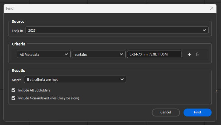

When you say "lens type" what do you mean? - lens manufacturer, lens model, telephoto, wide angle focal length etc? Or the precise lens model?
If you simply want to Find images taken with a particular lens, then you can use Find (Edit>Find or Ctrl+F) with search criteria "All Metadata>contains" and enter the precise lens model name. This is a rather slow process however.
This of course simply finds images and does not sort as you asked.

Hi . . . thanks for the very fast reply.  I appreciate it.
I tried the find option but never saw the All Metadata segment at the end of the list.  It worked beautifully.  Was able to search and find images taken with a particular lens, selected them all and copied them to a new folder.  Good to go, now.
