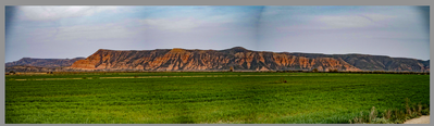

Here is what I see, to give you an example:
After importing and without profile corrections enabled, you can clearly see vignetting just by looking at the image. It becomes even more striking when combining the four pictures shown to a panorama and applying, just for the sake of demonstration, some (exaggerated) dehazing and histogram stretching:
This of course is not pretty and is meant to be only a demonstration. It looks to me like the dark parts are results of vignetting when stitching together the panorama.

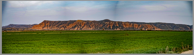

When I apply "auto" profile corrections, it will again use the "built-in" lens profile, which is equal to unticking the box:
(this is something else I don't understand with Lightroom, why is no way to remove the built-in, even when lens profile corrections are unticked? But this is a side question)
This results in the exact same panorama (I synced all edits to make sure the images are comparable).

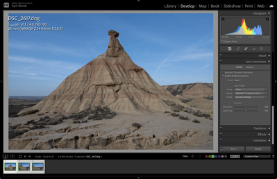

In the remaining steps, I want to demonstrate that the same steps would produce satisfying outcomes if done based on images taken with another lens for which there is a correctly functioning lens profile, such as the NIKKOR Z 14-24mm f/2.8 which I also own.
First of all: there seems to be a lens profile (see right bar) corresponding to my exact lens.

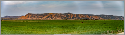

If I merge the three pictures and apply aggressive contrast enhancement, I can see no signs of the lens profile not being applied to the original images.
