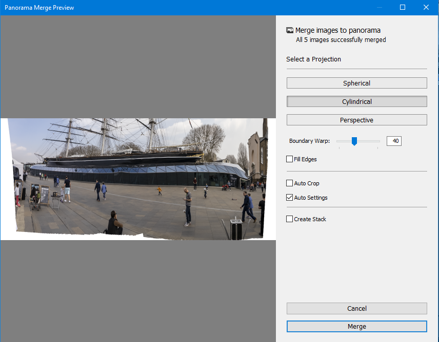

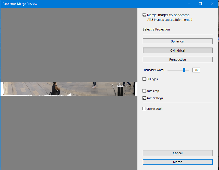

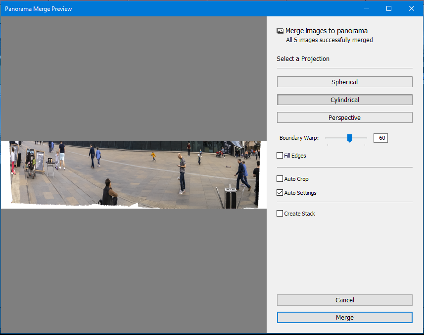

I have tested this myself on several different pano sets, and often (though not always) I can reproduce the reported issue. Using one particular set of 5 images, the problem is immediately apparent when using the Cylindrical projection - the preview is fine, but as soon as the boundary warp slider is brought into use one can see the preview is vertically cropped from the top, as per these screenshots:
First at 40%
Then at 60%:
Then at 80%:
And so on. Completing the merge in that preview state produces the same cropped file.

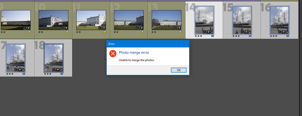

Another intermittent issue is when applying 100% boundary warp, then attempting to complete the merge using either Spherical or Cylindrical projections. Often, but not always, the result is an error as per this screenshot:
