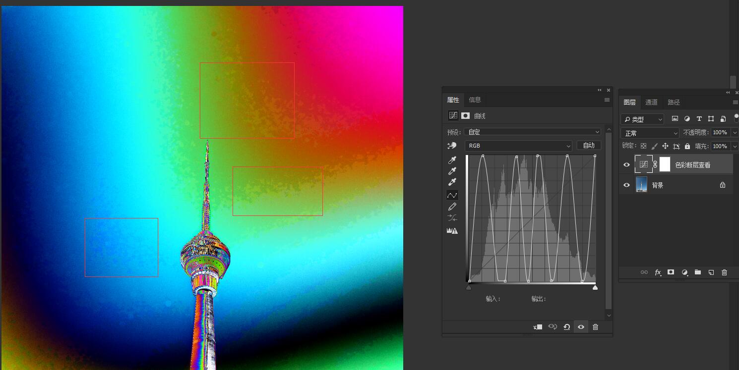

I comapre acr +ps  jpg and nx-d jpg in ps,I add a curve adjustment layer above the photo to monitor, as you can see below is ps jpg
Follow is acr+ps jpg ,Acr is default set
following is nx-d default set ,export jpg,that so smooth,no urgly

The NX-D images have more noise grain and this breaks up the color transition along a smooth gradient such as the sky in your photo.
Adobe isn't going to change anything.  You can set your own ACR defaults with NR at much lower settings if you want, although zero is too low if you are using ACR for normal, non-rainbow-gradient images:
Besides turning down NR so you have excessive noise grain, you can also just add noise using the Effects panel in ACR:
Or use Filter / Noise / Add Noise in Photoshop,

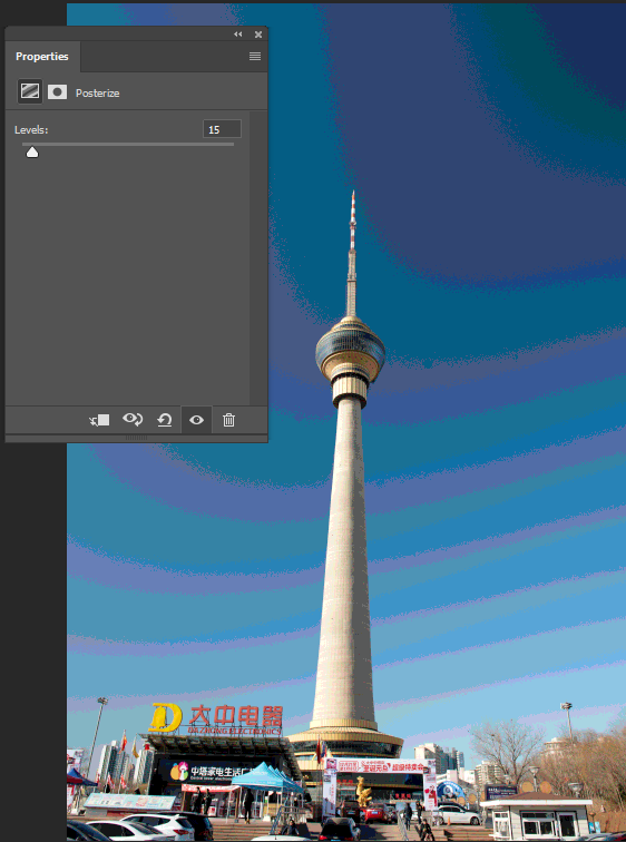

Turn down the Color Noise Reduction, from a default of 25 to maybe 5 for this image and the sky gradient will have smaller blotches:
Here I'm using a Posterize Adjustment Layer to create bands of different colors to examine the size of the color grain:

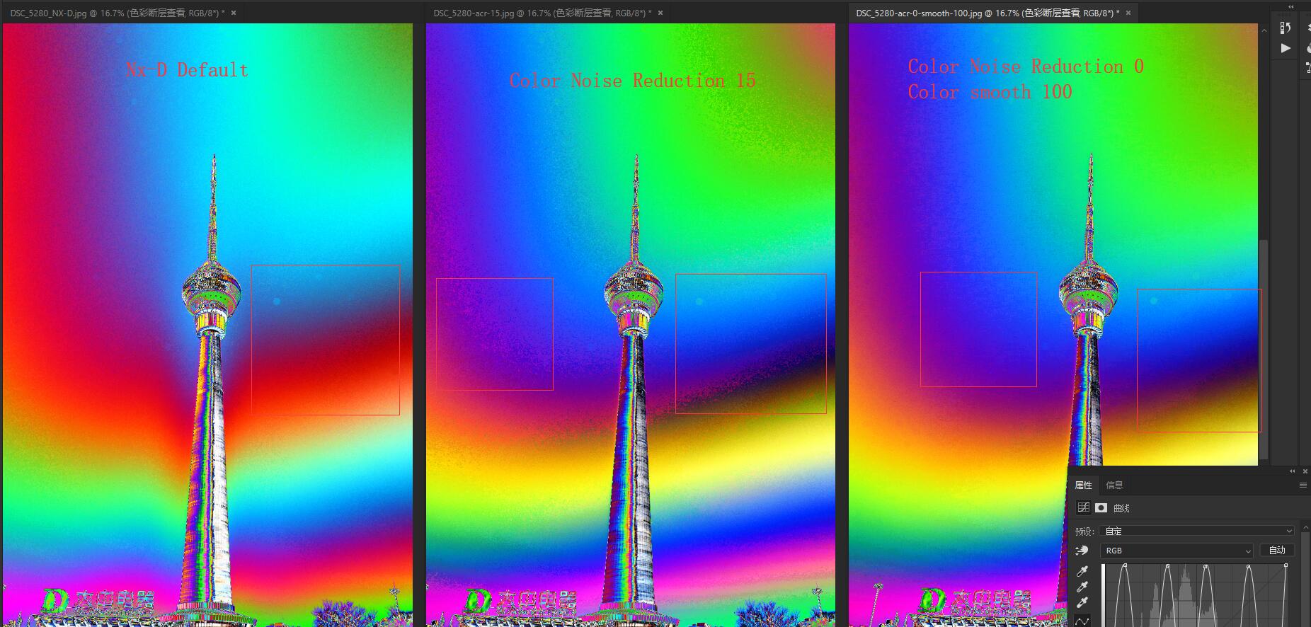

Jan 21, 2019 Jan 21, 2019
thank you ssprengel
I use your method to set the Color Noise Reduction, from a default of 25 to maybe 15 and even to 0,and color smooth from 50 to 100,that be much better then before,but compare with NX-D Jpg still have a gap.
I hope acr can imporve or fix this problem when load d750 raw file.
