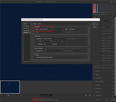

Copy-Paste a screenshot of your full ACR window into a reply, here, with enough extreme adjustments to turn on the red highlight clipping indicator for some pixels of an image.  Choose an image that can be publicly viewed on these forums.

Because raw camera data has no color space, when you open a raw image in Camera Raw, the Workflow preferences in Camera Raw  control the settings of a non-raw format exported or saved from Camera Raw. So if you want Camera Raw to send images to Photoshop at 16 bits per channel in the Adobe RGB color space, Workflow preferences needs to be set up that way.
Additionally, and possibly relevant here: The Color Space set in Workflow preferences controls the color space used to calculate the histogram, and to determine whether clipping is happening. You can see this in action by opening Camera Raw preferences (click the underlined text at the bottom of Camera Raw window), and watch the image preview in Camera Raw as you change the Color Space setting. If there is an area of the image that is close to or slightly clipping in a large color space such as ProPhoto RGB or Adobe RGB, choosing a smaller color space such as sRGB will now indicate more clipping in those areas, because they are now outside the new, smaller Color Space selection. Also, as you change the selected Color Space, you will see the histogram change in the Camera Raw window for the same reason: Both clipping and the histogram are calculated against the current Color Space.
