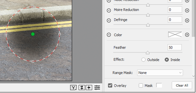

Title says it all: in camera raw selection inside for radial filter does nothing. Changes are still applied outside.

Does the on screen outline change colour?
Outside
Inside
If not try going to Preferences >Camera Raw and uncheck "Use Graphics Processor"

It does not change color as shown in your examples, which it used to. Unchecking Graphics Processor did not help either.

Just tried resetting the camera raw settings, the issue remains the same. Notice the exposure -4.00 is done on the outside, while inside is chosen and the edge remains green.

Ok, so I just updated the Camera Raw app, and I still have the issue. The radio button does not work, however the shortcut for switching between inside/outside 'X' does work, so at least I can actually change it, while the radio button still does nothing.
