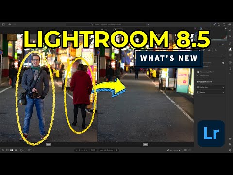

Also see this video by @brianmatiash where he demos the feature: https://www.youtube.com/watch?v=YwpUX4b6igY
Posted by:
This Lightroom v8.5 update improves Generative Remove with cleaner output and up to double the speed. We'll also explore Adobe Camera Raw's new Auto Dust Spot Removal, which can clear most dust automatically. Finally, I'll cover the updated AI Edit Status menu and share tips to prevent ...
