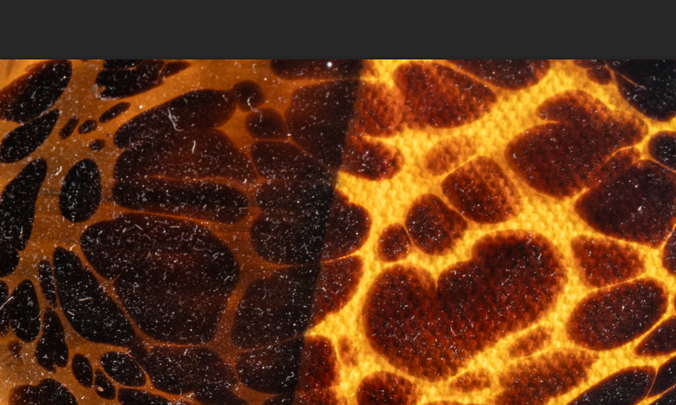

I tried it on an image with about a hundred tiny dust spots, and it failed pretty badly.  I'm sure it will work on easier images.
