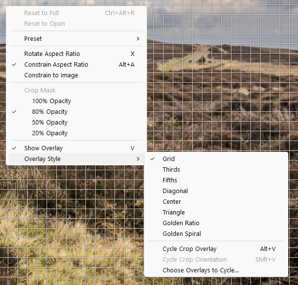

Advisor ,
Feb 28, 2024 Feb 28, 2024
Before you enter the Crop Panel, set up the grid size and opacity to your requirements just as you used to do.
Now enter the Crop Panel.
Press "V" to toggle overlay on or off.
If you don't see the grid you set up but some different overlay, then right click within the image and choose Overlay Style>Grid.
Then whenever you enter the Crop Panel the grid you set up will show.

LEGEND ,
Feb 29, 2024 Feb 29, 2024
Right-click for overlay options including disabling the grid. See the screenshot posted above.

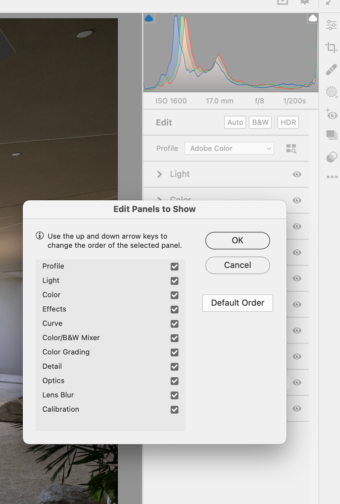

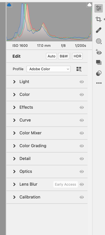

The Geometry TAB within Camera Raw (16.2 Mac Os Sonoma) converter is no longer visible. I've tried to "edit visible panels" but doesn't even appear as an option. For some reason can only now find it under the crop tool. Thanks in advance for any suggestion!
Mar 03, 2024 Mar 03, 2024
<"moved from using the community">
Advisor ,
There is no longer a Geometry Panel. Geometry now resides within the Crop Panel.
Community Beginner ,
Thanks for the follow up Erik! I wasn't aware of that but guess I'll have to get used to that change and new location.
