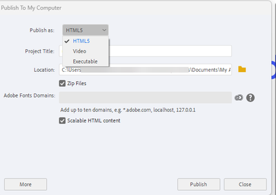

I didn't zip and then SCORM. I published to HTML (because that's really the only viable option available) and checked "zip" from the publishing screen. Is there a differen't way I should be doing this?
Sep 03, 2025 Sep 03, 2025
OK.   Some LMSs are very "picky" about what they consider to be a "quiz".
Sometimes you can trick them by adding a scored button (that reports to the quiz) on the slide AFTER your video and force the user to click that button to advance to the end of the course.  Clicking the button sends a score to the Quiz variable.  Since there is only one scored object in the "quiz" the LMS views the quiz as passed as long as that button gets clicked.
