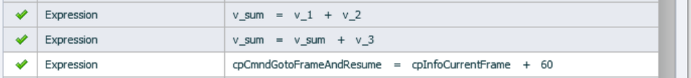

To calculate in Captivate you need to use the Expression command. It has the four main mathematical operators.
Some examples:
Besides +, you have - * and /
I added the last line to show that calculation can be powerful: that command will skip 60 frames (2 seconds if the default 30FPS is kept) on the timeline. Check out the end of this thread, where I took advantage of that type of workflows:
https://community.adobe.com/t5/captivate-discussions/how-to-resume-audio-from-where-it-last-stopped/...
You are showing only the logical operators for a condition. Bit amazed that you always ask for JS whereas you didn't yet explore the possibilities of the point-and-click actions in Captivate.
