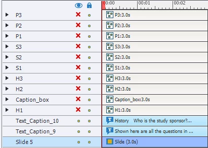

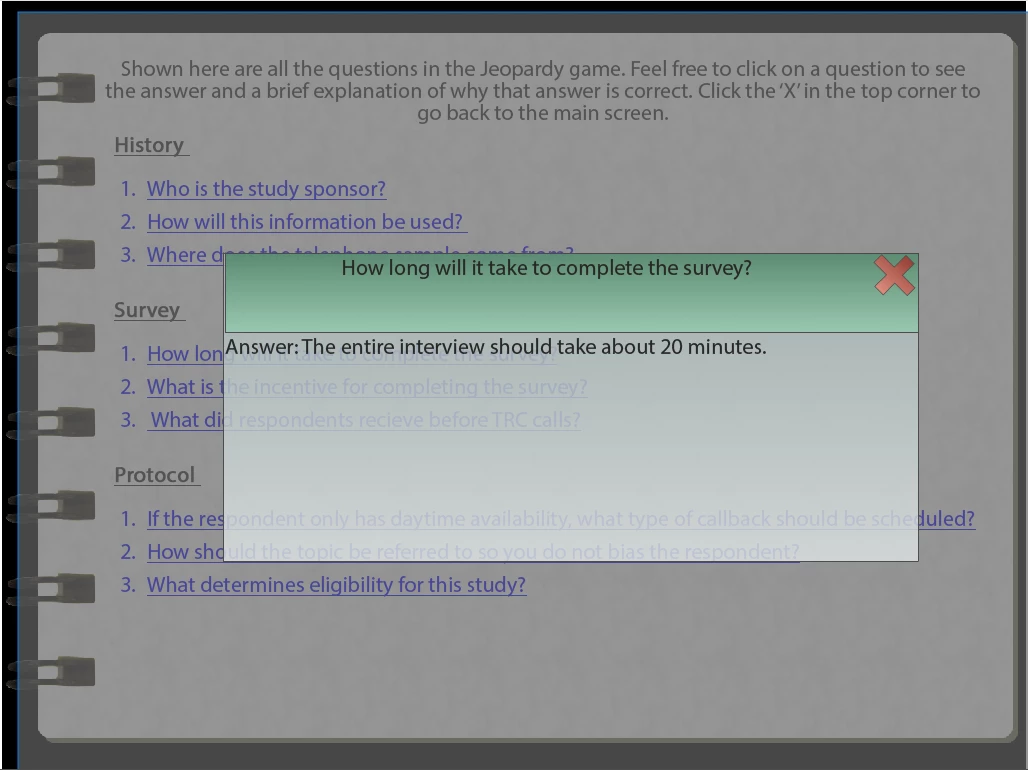

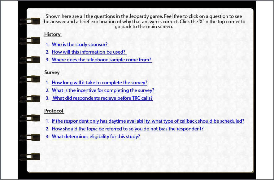

I've got a slide where I am explaining the answers to a game earlier in the captivate. Each question is a hyperlink that executes an advanced action. That action is currently to show a grouped set of objects (highlight box to mask the rest of the screen and two boxes with text captions). The top of each box has a red X that I am using as a button. Clicking that button launches an advanced action that simply hides all these objects.
Screen without a caption box:
Screen with a caption box:
My timeline:

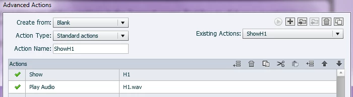

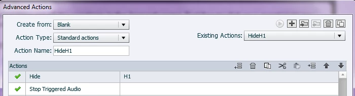

I am trying to add audio to these text explanations, but am unable to get the audio to play. I edited the advanced actions for the hyperlinks to read "Show H1" (the grouped objects for that question) in the first line and "Play audio H1.wav" in the second line. I also changed the advanced actions connected to the red Xs to be "Hide H1" and "Stop Triggered Audio".
Unfortunately, when I do this, the audio does not play. From my limited knowledge of captivate, updating the advanced actions to what you see above should cause a specific audio file to play when they click the hyperlink and that audio to stop when the red X is clicked. Currently, the audio does not play.

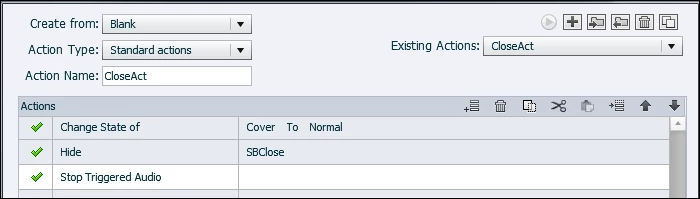

Update: I tested this out in Captivate 9, with the example I created for the blog post: Playing with Captivate 9 - Captivate blog
It works perfectly for me: I added a Play audio command to the shared action I used to show the lightbox, and Stop Triggered audio to the Close button action.
I did test both in Browser and in HTML browser to check if it is working for SWF and HTML output. For such a command I never had the experience that I should have to publish to have it functioning, maybe I'm lucky.
This is the shared action, I used Change State instead of showing Lightbox, the Show action is for the Close button.
For the Close button:
