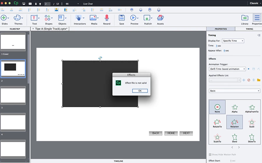

After that, I decided to give some image and shapes an effects (from the TIMING tab, in the sidebar).
However, this is what happened:
A pop up window appears, and says "effect file is not valid".
I can't add effect nor preview the effect at all.

janm68737111
June 13, 2016
I have exactly the same problem.
It is a project based problem, so simply create a new blank project with only one blank slide and add the image and event there and then copy/paste the image with the event to the slide in your old project. Worked like a charm for me.
