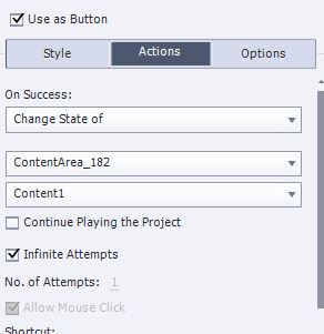

I believe that I have to create variables and advanced actions on each button to create this logic, but how can I add additional actions on the same button? I see under 'ACTION' that all buttons already have an action to open the content of the state view when clicked:
Is there a way to add another action to the same button?  Please share instructions to help me create the logic to achieve this? Many thanks.

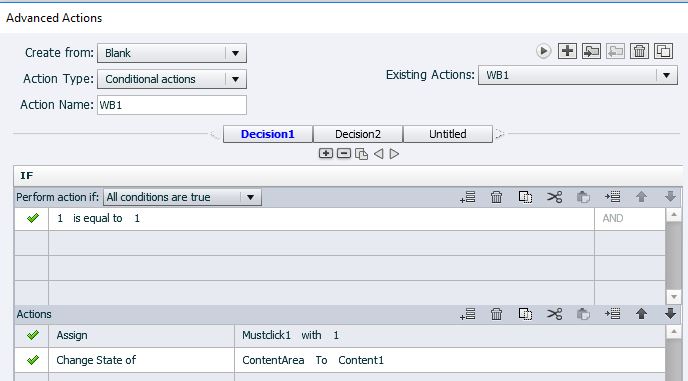

Here's what I did. As suggested, I created a script for each button,and changed only the first decision point.
Scripts created are WB1, WB2, WB3 and WB4. All 4 buttons are paused T 1.5 sec.
Example Action WB1: Decision 1
Note: The variables: MustClick1, 2, 3 and 4 are originally set to 0:

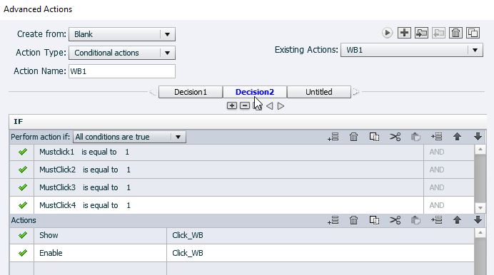

Action WB2: Decision 2:

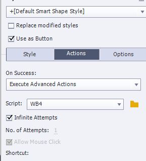

I assigned the advanced action WB1, WB2, WB3 and WB4 to each button.
Example, button 4 executes script WB4:

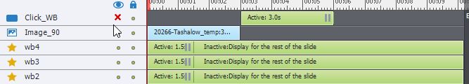

When I preview the project and I click on all 4 the buttons, decision 1 action on 'Change state of' is working ok because I do see the content it should display, however after clicking the four buttons, I was expecting to see the 'Click_WB' button (which is hidden from the start), but it didn't appear.

There are two possible reasons:
  1. You need to have that Next button (Click_WB) to start from the start of the slide. It will never be visible in your case, because the playhead remains stuck at 1,5secs and the button's timeline starts only at 3secs. BTW: why is that slide so long? Do you have slide audio?
  2. I see that you did hide that button on the stage, which is not the same as hide it in Output. That is done in the Properties panel, with the eye icon button that you'll find there.
BTW: be careful with names, you cannot use same name for two items, even though they are totally different. Lucky for you, names are case sensitive.
I told you to have the pause of the Next button at the same point or later, not to have the timeline later on the slide.

You are a star Lilybiri! It worked!! . I changed the next button to the start of the slide and I also hid it in output.

But the playhead is stopped at 1.5 seconds and the button doesn't begin to show until 3 seconds.
Try adjusting the button so it shows immediately or some time before the pause of the three buttons.
