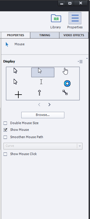

I'm brand new to Captivate, I've recorded a Video Demo of a website.  I want mouse click sounds but I don't have them.  Searching for the answer people say to turn Mouse Edits on, then click a mouse icon on the timeline, then adjust the settings in Properties on the right hand side.  But I don't have Mouse Click Sounds present in the properties.
I'm running the 30 day trial of Captivate 2017 - but I thought the trial was a fully featured version of Captivate, so I don't know why I don't have the same options as everyone else!  Can anyone else help?  I'm on a deadline here and don't want to have to drag this into Premiere and add click sounds for like a ten minute software demo
Here's a screenshot of my mouse properties panel:
Thanks

Trial version has all features of the full version.
I don't know who told you about the mouse click sound. For cptx-projects, software simulations, that mouse click sound is available in the mouse properties panel. That is not the case for cpvc-projects.

Using a cptx project, software simulation which allows creating an
interactive tutorial contrary to a passive video.
