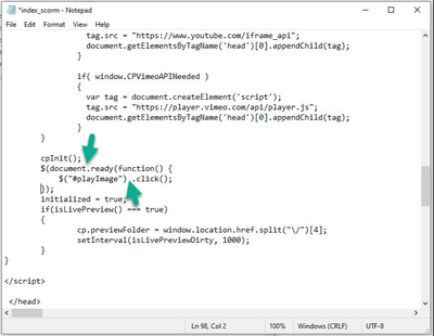

Here is what I do to get past the Play button but it has to be done after you publish your project. This works well for desktop and laptop engagement but has mixed results on mobile touch devices. I am still trying to figure out a relatively simple solution to simulate the touch versus a click.
After publish - open the index.html file in your favorite editor.
Head down to line 96 - add the highlighted text - see pic below.
Save the changes.

Compare your portion of the code with mine from the picture.
It looks like you removed three lines.
We need to insert the three lines of code without removing anything else.

Can you post a screenshot of  the code including several lines before and after?
New Here ,
Aug 01, 2022 Aug 01, 2022
Here is the pic of the code. Also here is the code in the script:
var tag = document.createElement('script');
tag.src="https://player.vimeo.com/api/player.js";
document.getElementsByTagName('head')[0].appendChild(tag);
cpInit();
$(document.ready(function() {
$("#playImage") .click();
initialized = true;
if(isLivePreview() === true)
cp.previewFolder = window.location.href.split("\/")[4];
setInterval(isLivePreviewDirty, 1000);
Advisor ,
Looks like a couple errors in the code.
I see a missing parentheses and an extra space at the spots indicated.
I would start there. - Compare with my code higher up in the thread.

Updated the script with the changes and still have the issue.
cpInit();
$(document).ready(function() {
$("#playimage").click();
initialized = true;
Advisor ,
I see now that you have a lowercase  'i'  on playimage
Should be a capital  'I'  as in  playImage
