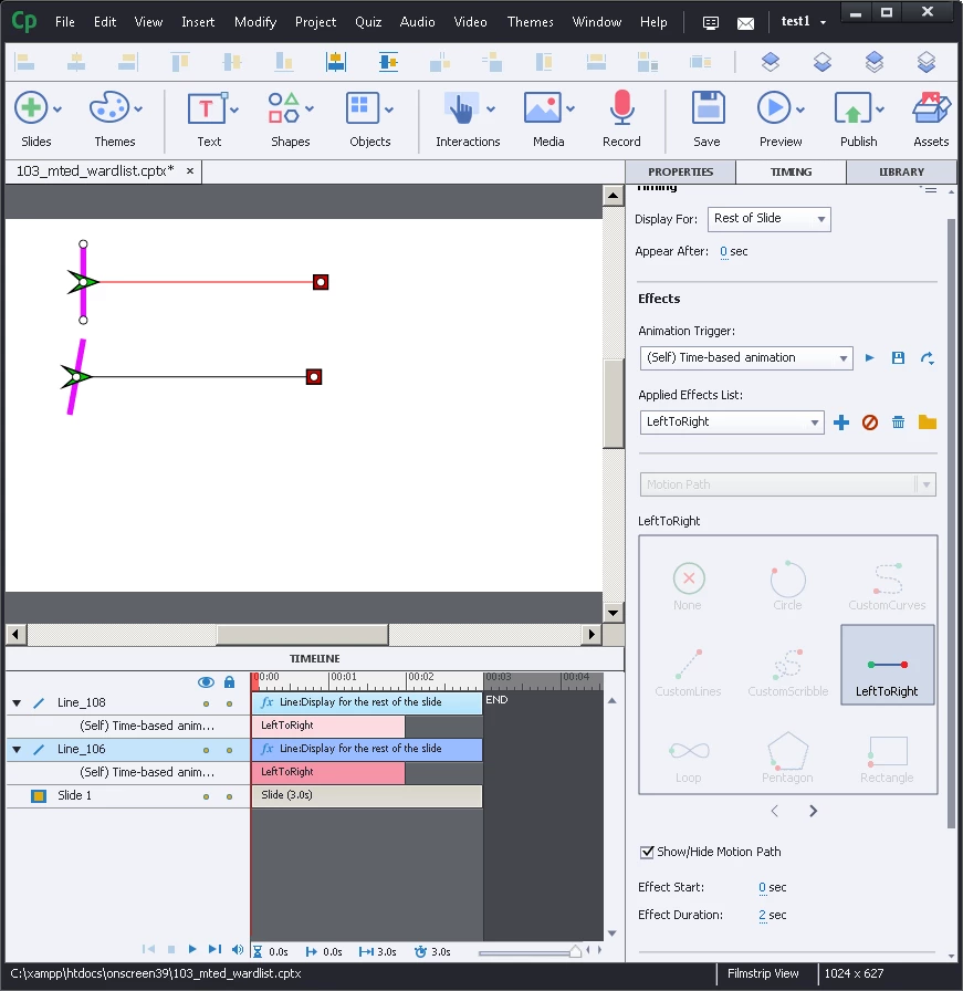

I created a vertical line and gave it a left-right motion path.
I duplicated the vertical line and adjusted the bottom end so that it is now at an angle.
When the project is previewed or published in HTML5 only the angled line moves, the vertical does not move.
The same result happens when the motion path is changed to another type of path.
(It all works fine is Flash, both lines move, but I don't publish anything in Flash)
I do not need a solution, I have worked around the problem by moving the line just by 1 pixel.
I just thought it may be of help to anyone else who comes across this problem.

    Line object has a lot of problems, it is also the only shape that cannot be rotated (look in Options).
    Whenever I find a problem with that shape, I just replace it by a rectangle with a width of 1px, because I have given up trying to find reasons for that behavior.
