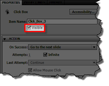

Something new:  If I put a very small click box on the slide in an out of the way place, it can be used to pause the slide.  Then the user clicks the nav button that is automatically created by Captivate.  Now I don't have to get rid of that nav and all I need to do is paste the little click box on every slide.  Strangely enough this only works when the click box is set to "visible" however it is NOT visible in the preview.  That works for me.

Sounds like you are misunderstanding the visible option. By default, Click Boxes are always invisible. The visibility option governs whether they are present at run time. For example, perhaps you have a Click Box that opens a PDF containing a certificate of completion. But it should be present and clickable only under a specific condition. In that case you would clear the visibility and use Advanced Actions to control whether it's available at runtime.

If this doesn't happen, it means that the click box and/or the 'smart shape' button are invisible in their properties.
