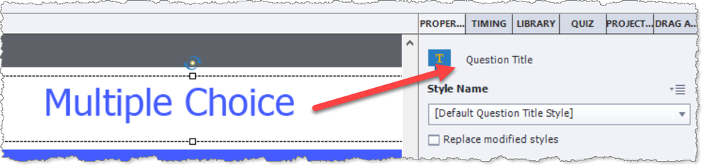

I think you will find that cmi.interactions.n.description, or Question Title, is just referring to the text that appears at the top of each Quiz Question in Captivate to identify the type of question. (True/False, Multiple Choice, etc).
You can verify this by adding a quiz question slide, selecting the text caption that tells you what type of question it is, then looking at what that object is shown to be in the Properties tab.
QuizQuestionTitleObject.pngMany Captivate developers make the mistake of removing these text captions because they think they are optional or redundant.  But in fact they supply valuable information to the LMS via SCORM variables.
You should be able to do a quick test with a simple project containing a few different quiz question types uploaded to your LMS.  Get your LMS Admin person to extract a report from the LMS showng data from the description.  If it just tells you the question type, then you know how to configure your description.
Although the developer can edit the text in these captions, I think there is a limit to how many text characters you can include and maybe even what types of characters.
