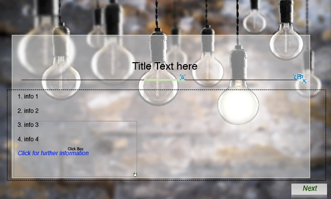

I have underlining lines on a slide, over an image, which appear fine in Captivate but disappear in Preview (all of the options).
I original had them set on a master slide, but they weren't showing (if I click master slide objects on top, everything disappears behind a white screen?).
I recreated them over the top of the image on the individual slide, but still no luck.

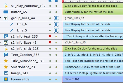

They are almost at the top of the z order (I've tried at the very top, but not showing). I've tried grouping and ungrouping them (there are two overlapping lines), locking and unlocking their position. I duplicated the slide and recreated them. Still no luck.
I'm using C9.0.2.437, responsive project.
I'd be grateful for any further suggestions please.

    Try to ungroup lines, I had similar problems with the lines contained in a group that not apear in the publication.
    if not, actually the lilybiri solution seems to be a good alternative.
