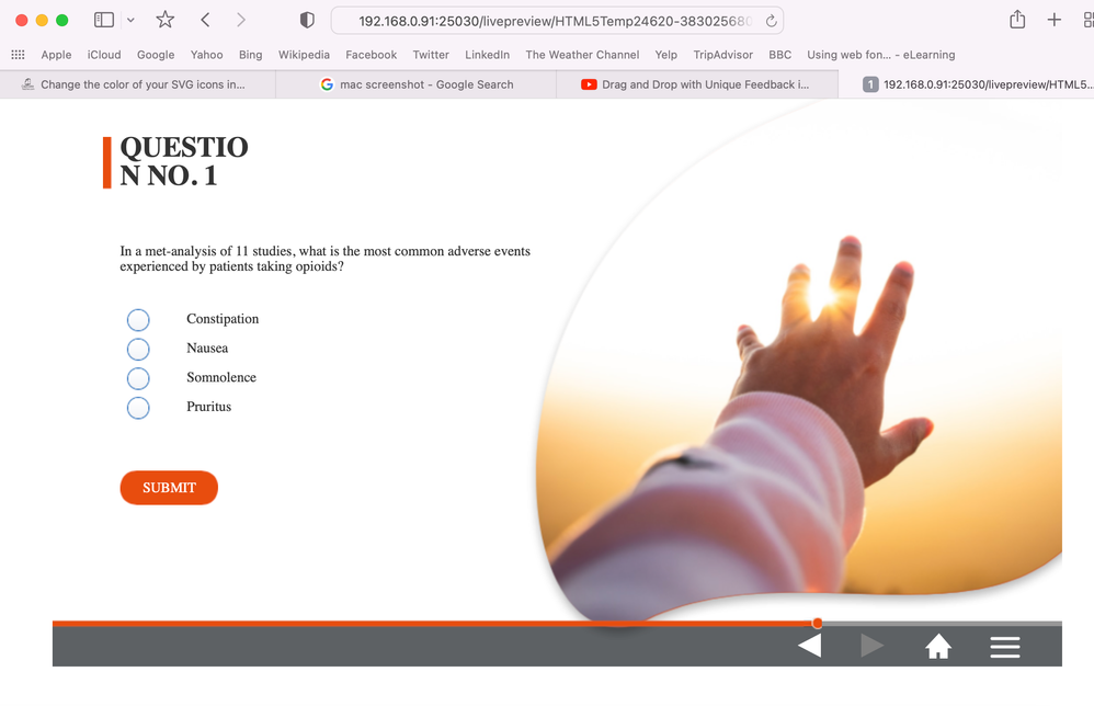

New Here ,
Nov 18, 2021 Nov 18, 2021
It's true you can't change the top and left values. But you can change the margin and probably padding.
I made a long bar with a dot at the end as a progress indicator, 2000px wide and set left to -1988px (since at least part of it has to be in frame).
I then changed the left margin according to proportion of the way through the slides using a javascript advanced action (prefix your object with "re-" and suffix it with "c":
const elem = $('#re-Progress_dotc');
var currslide = window.cpAPIInterface.getVariableValue('cpInfoCurrentSlide');
var numslides = window.cpAPIInterface.getVariableValue('cpInfoSlideCount');
var margin = (currslide / numslides) * 100;
elem[0].style.setProperty('margin-left', margin + '%', 'important');
Which gives me this, my image being the orange bar with the dot at the end:
