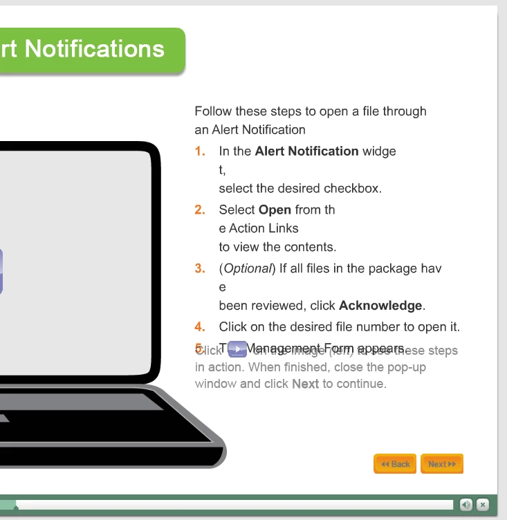

Here's the situation:
I created a few slides in PPT (2007) with simple text animations. I created a captivate project using v 6. I imported the ppt slides into my captivate project (using high fidelity). Great. I realized I'm missing a few slides, so while my captivate project was open, I opened the original ppt project (not through captivate) and created my new slides and saved the file. I closed PPT. I then went back to my captivate project and inserted  new ppt pages and tried to import only the new slides.
When I preview the project, any slide to which I had made text changes in PPT appears choppy/cut off (see attached screenshot). I tried creating a brand new captivate project and importing all of the slides over again and still the same issue.

December 14, 2012
I wanted the bullets on the slide to appear one line at a time that's why I chose to create the slides in PPT. As far as I know this feature doesn't exist in Captivate.
What I found ended up fixing the problem is  creating a brand new ppt slide, with a brand new text box and typing in the list. The copy/paste appears to be one of the bugs that causes the cut off text. I created a new captivate project importing the PPT slides and when i confirmed it worked in preview, I copied the slide (in captivate) and brought it into my original project.
That's a lot of rework but now I know what to avoid.
Thank you for the link.
RodWard
December 14, 2012
In Captivate, if you want bullet points to appear one at a time, you just use multiple captions and space them out on the timeline.  Maybe not as slick as PPT, but it only takes a few moments to set up and is very easy to modify when you need to time it to voiceover.
