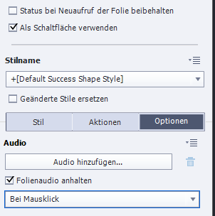

    As Rod points out it is necessary to use only slide audio in that case. Only that type of audio is synchronised with Captitvate's slide timeline. Using the commands Pause and Continue will act on all objects/effects but also on slide audio. However a pausing point of an interactive objects will only pause slide audio if you do activate that in the Options tab:

    Which solution did you use? I just now see your timeline screenshot, was not there when I tried to supplement some ideas to Rod's answer. Screenshot is bit fuzzy and small. The three buttons appear only after the end of the audio clip which is indeed slide audio. It is a fluid boxes project.
    My question is meant for other users struggling with the same problem: which solution?
