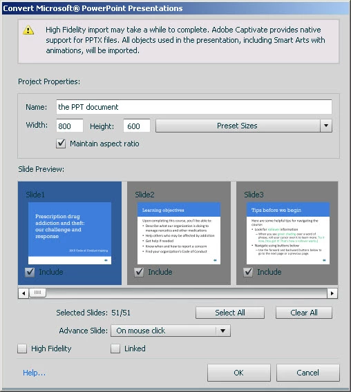

    Another question:
    Should I have selected "High Fidelity" when converting the PPT to Captivate 8? (I didn't select it because I didn't think that the PPT had any animations in it.) Following are the settings that I used for the original conversion:
    Thank you.
    Jan

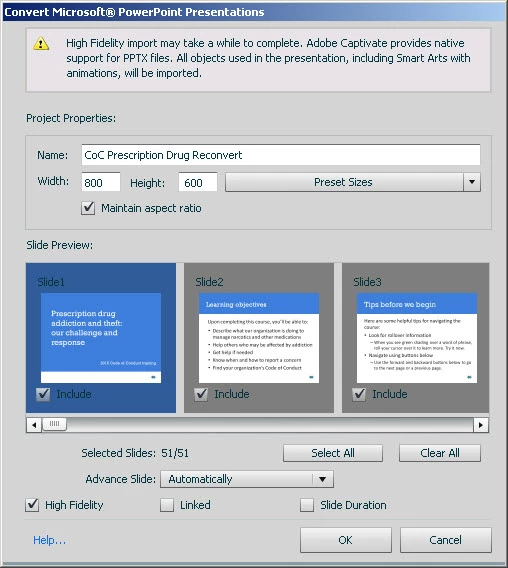

    We fixed the problem it appears. We did several things:
    - Removed hyperlinks from the PPTX file in the PPT app, and saved the updated pptx file.
       Note: these slides with links started on slides 38 and 39 -- right after the problematic slide 37 that froze in Captivate preview.
    - Closed the PPT app. Also shut down the PC.
    - Made sure PPT app was NOT open when doing the Captivate - generate new course from PPT procedure. And used these settings:
    Hope this helps someone else.

    John_Meidl
    October 16, 2015
    Another question:
    Thank you.
    Jan
