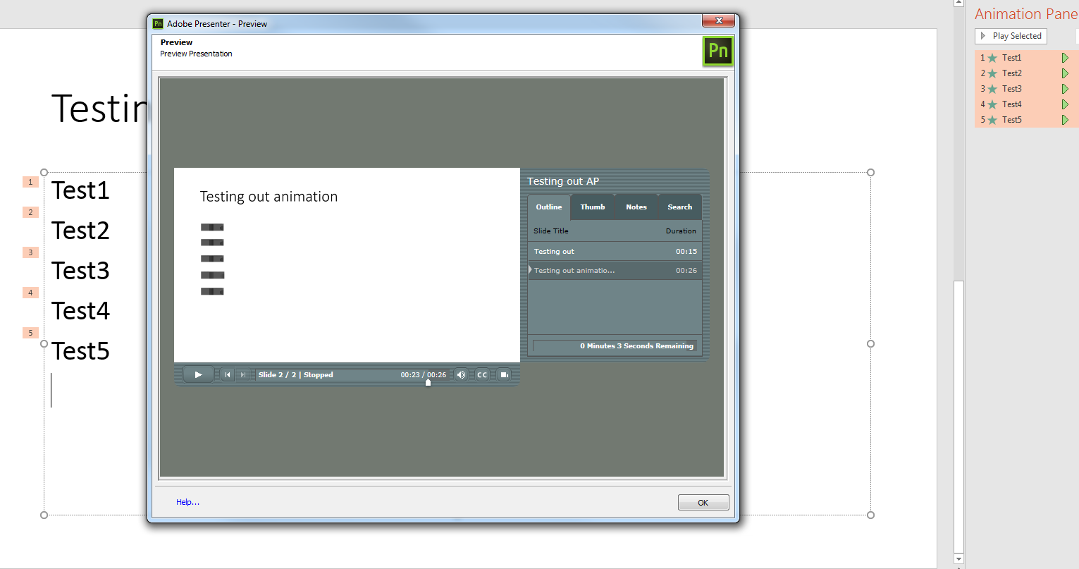

When I'm recording audio on slides with animations (simple appear animation on-click) it shows up great in the recording area. However, when I preview the presentation (either by the 'preview in HTML5' or publish to HTML5) the text does not show up. I've tried:
  • not using bullet points
  • various animation types
Each time I preview it, it either shows a stretched bullet point with no text or just a border around the text. (see attached)
Please help.

If you edit that slide, are the clicks showing at the very end or are they showing within the slide? I usually have to adjust the click points within the presentation. Also if you use transitions, they cause issues in HTML5 and do not work in it.

I don't believe this has anything to do with the transition. I too see distorted text when animated and published to HTML. Granted I'm on 11.0, but the upgrade doesn't seem to have any effect. I tried different animations and changing the text to different fonts and nothing changed the result.
Here is my published sample: Animation test - HTML
I'd recommend you reach out to Adobe Support, and have them look at what is happening and work to provide a solution.

Just out of curiosity, have you attempted to uninstall Presenter and reinstall it? I did your test and was not able to replicate it. Only issue I am seeing on my end, is the bottom line of text is cut off, especially when the line has no hanging characters, like a p.

So i'm doing a simple text animation which works in the recording of the audio section of Presenter (see from 0:00). However when outputted to HTML, it does the transition but shows a distorted image (see from 0:20). This HTML publish is on a web server, not just in preview.
