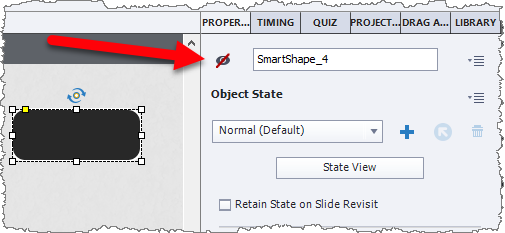

In reading over your original post I think your issue might have been that you did not set the objects Visible in Output property to OFF initially so that they would not be seen until the SHOW actions made them visible.
Look for the small 'eye' icon beside the object names.  You can toggle the initial visibility via clicking this icon.

You misunderstand me. Any (I can almost hear Lilybiri screaming somewhere in Belgium) you don't understand how the Captivate timeline works.
The 'eye' icon I am referring to is NOT the eye icon seen in the timeline panel.  That one just turns off visibility of the objects on the slide during EDIT mode, when you are editing the content inside Captivate.
The one that you need to pay attention to is a different 'eye' icon that appears in the Properties tab when you have an object on slide selected.
If you want objects placed on a slide to be invisible to the user UNTIL they are SHOWN by an Advanced Action executed by a button or other interactive object, then you need to set the Visible in Output setting to OFF for each of those objects that should be hidden.  If you do this, you could have those objects timed to be right at the beginning of the slide timeline but they still would NOT be seen until the Advanced Actions show them.

Oh sorry...yes. Turning off the eye icon in Properties fixed the issue. The slide is working as expected now .
