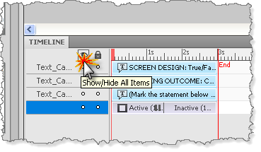

I've often found that weird issues with quiz question slide behaviour are often due to Captivate authors having removed or replaced some of the default captions such as the Question Title, or Question Text captions.
Try this:
  • Open each quiz question in your movie in turn and check to see that they ALL have a Question Title and Question Text caption at the top.  Replace any quiz question that is missing these components.
  • For any question slide that still DOES have Question Title and Question Text captions, use the Show/Hide All Items icon to try and hide all items on the slide.
  • Watch to see if on any quiz question the Question Title or Question Text captions disappear when you do this.
The Show / Hide All Items button should NOT hide any default element on a quiz question slide.  It should only hide elements such as captions, images, animations, etc that were added by the author.  So if using this icon DOES hide one of these captions, it means that somehow the default ones have been replaced.  Since you cannot add back these items AFTER removing them (because they're not actually a normal text caption) the only way to fix these slides is to replace them with brand new quiz question slides of the same type.

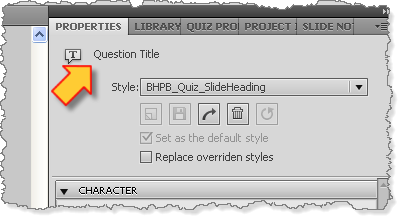

Hi So whenever we create a quiz slide, we retain all the components except one.
Whenever we add a question slide, we select the type of question we want. For eg. if we select multiple choice. When the slide appears it has the original components which are:
1. Multiple Choice - I am assuming this is what you mean by Question Title.(We ALWAYS delete this and add our own Title.
2. Question text captions - Option A, B, C etc....
Does deleting the Multiple CHoice caption wrong?Is this what you are saying?Are we on the same page given the understanding of my problem Rod?

If you select the caption that says Multiple Choice or True / False etc and look at the top of the Properties tab you will see it says Question Title.
Do the same for the caption that contains the actual question and you will see it called Question.
I've found it is unwise to delete or replace either of these two captions.  They are unique to Quiz Question slides and are NOT normal captions.  I don't know why they are required for reliable functioning of quiz question slides, but I've seen too many instances where messing with them causes weird issues.
There is NO reason to delete the Question Title caption if all you were going to do was replace it with another caption.  Although the Question Title is by default a transparent caption, you can set it to use any of the default caption types, and you can use Object Styles to change the default look and feel for any new question slides added to your project.  Look for the Title (Question/Result) default style in the Object Style Managers under Quizzing Objects > Captions.  This style ONLY affects the quiz question title captions.  THAT should show you that there's something very special about these captions.  There's also a specific Object Style for Question Text too.  Change these to what you want.
It doesn't seem to matter which quiz question in your project is missing one of these captions.  Sooner or later you will end up with seemingly random quizzing issues that are very difficult to track down.  So best practice is just to NEVER remove these captions from your question slides and NEVER replace them with ordinary captions.  If you don't want them to show for some reason, just remove most of the text in them and move them ALMOST off the stage so that no text shows on the stage.  As long as even a small part of the caption is still sitting over the stage area Captivate will count the captions as being present.  But if you move them entirely into the scrap area around the stage, they will be as good as deleted as far as Captivate is concerned and you will have issues.
