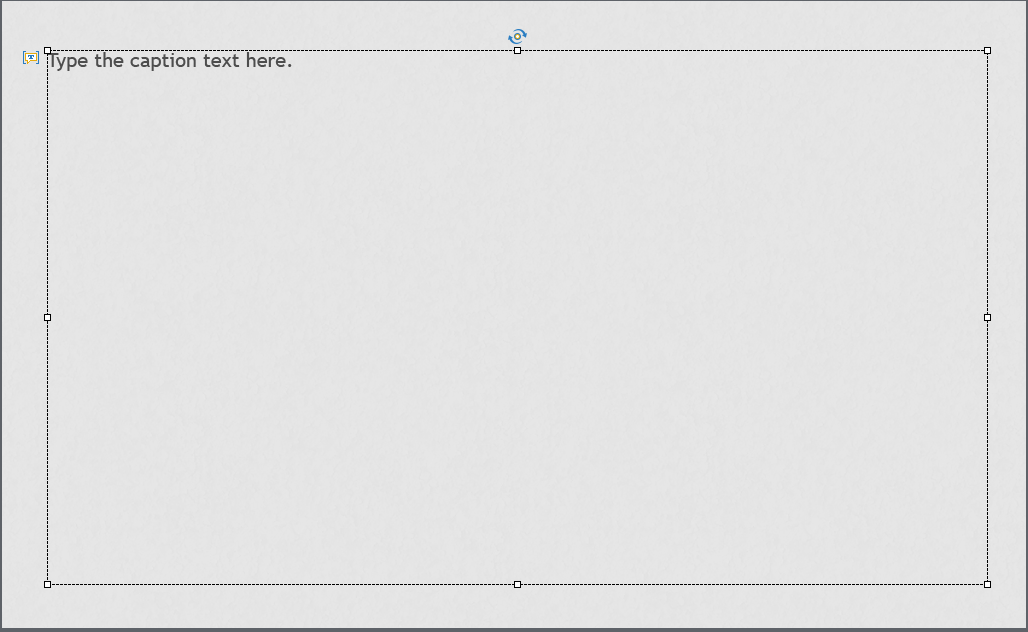

I am trying to set up my theme, but when I duplicate a slide so that all the placeholders are in the same place, when I try to resize the placeholder, it is stuck on constrain proportions. This means I can't go from one large text placeholder to having two columns for example.
Any tips? I'm on Captivate 9.

    1. It's a responsive project.
    2. I just created a new project (also responsive) and it seems to be doing the same thing.
    This is what I did.
    1. Used a blank master slide in the theme
    2. Put in a Text Caption placeholder and made it take up the whole area
    3. Duplicated the slide
    4. Tried to resize the placeholder so that it only takes up 50% of the width but stays the same height, but even when I use the side centre handle, it acts as if I have Constrain Proportions turned on somewhere.
    I hope that makes things easier to understand.
    Thank you.
    Lorraine.

    Hi Lorraine,
    Right click the text caption place holder-> Align, check whether Center horizontally on slide / Center vertically on slide is checked. If so, uncheck it and try.
