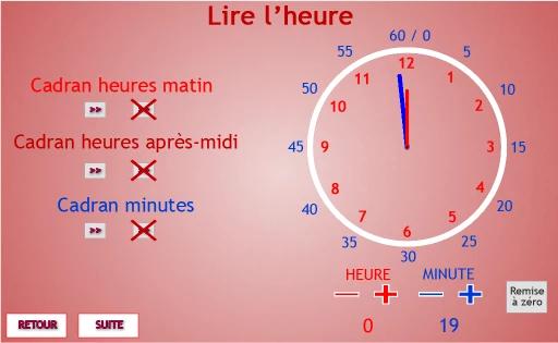

Hello !...
I'm starting to work on the clock !... (What a challenge !... )
I already manage to do many great things... But I have a problem with the rotation of the hands.
I want the students to be able to rotate the hands clockwise and anti-clockwise.
So I made a "+" button to rotate the minute hand clockwise. I use the cpt effect "rotate 6°" for each minute. And it works fine.
I also made à "-" button to rotate the same hand anti-clockwise (using also the cpt effect "rotate -6°"), and when I did so, the hand returns to its original (vertical) position before the rotation !...
So for example, if I rotate the minute hand to 20 using the "+" button, and then I want the hand to be on the 19, if I click on the "-" button, the hand returns to its original position before rotating... And this is not what I want !...
Don't know If I'm crystal clear !... ...
I will make some screenshots !...
And I clik on the "-" button one time this happens :
So the minute hand returns to its original position before rotating, and I want to avoid that !...
Is this possible ??...
I also made a button to reinitialize everything (Remise à zéro) but I don't know how to make the hands returning to their initial positions (vertical)...

I finally manage to do it... but with 60 conditional actions !!!... (1 for each minute you have guessed !...)
I created a variable called "Minute", and my minute hand is called "G_Aiguille".
So one of the action is for example :
If Minute = 12
Rotate "G_Aiguille" by 72 (6x12)
Luckily for the hour hand, I will have only 12 conditional actions !...

July 31, 2018
How do make the clock hands rotate? I would add custom states for the hour and minute hands and display the correct state whenever you increase/decrease the minute and hour variables. That would avoid having the hands to snap back first before they rotate. I had built an analog clock a long time ago, see here the second example: http://dev.keypointlearn.com/blog/clock/
