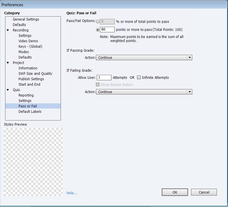

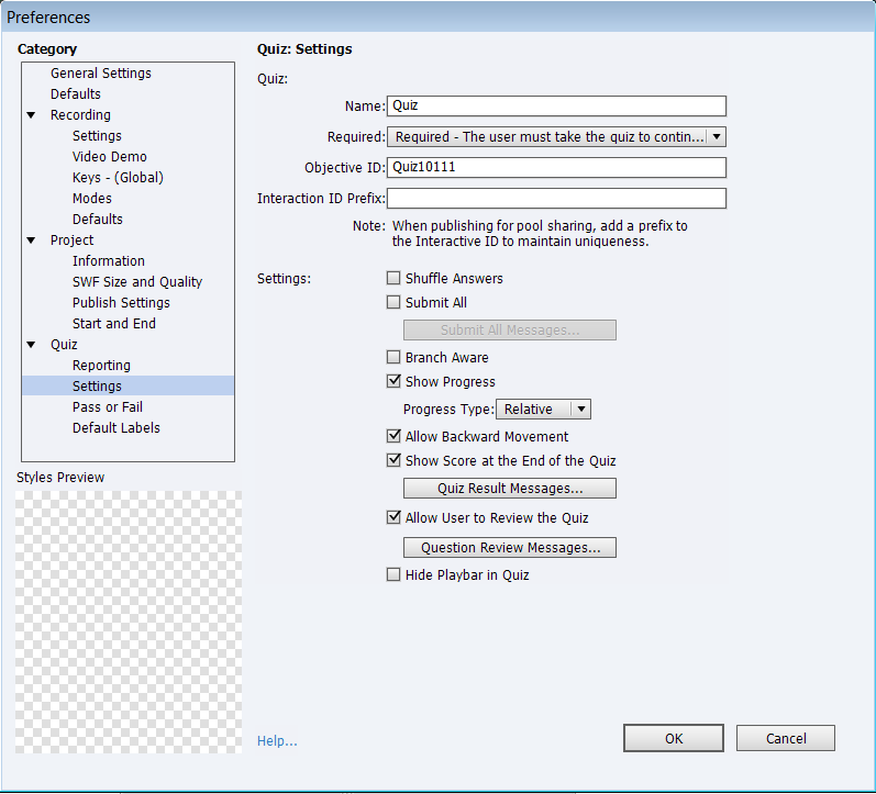

Still can't get this course tracking with scores.  Herewith the screen shot.  Does anyone know if the settings I have chosen for the quiz are correct.  When I load the published course into the lms and test it, it shows "not attempted" prior to opening it and it gives the final score on the last quiz slide.  There is a slide after the last quiz slide.  It still seems not to transfer the scores to the lms.  I recently found out that we have Scorm 2004 version 4, so I changed the configuration setting as it was defaulted to version 3, but that still hasn't helped with the scores.  Under the start and end settings, I have chosen close project for the end.   I have been through a week of torture with this course!  Please can anyone assist as I'm not sure what to do anymore!

I cannot see anything wrong with your settings.
Upload the same course SCORM package to SCORM Cloud online LMS (its free) and see if it scores OK there.  If it does, go back to your LMS administrator or vendor and ask why their LMS doesn't work as well as SCORM Cloud.  (They hate being unfavourably compared to SCORM Cloud.)

I would stick with SCORM 2004 3rd Edition and use the default template.
Could it possible have something to do with the scoring 80 our of 100? Do you max points available = 100?
