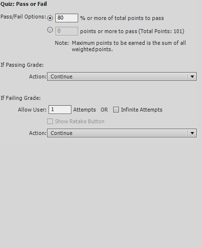

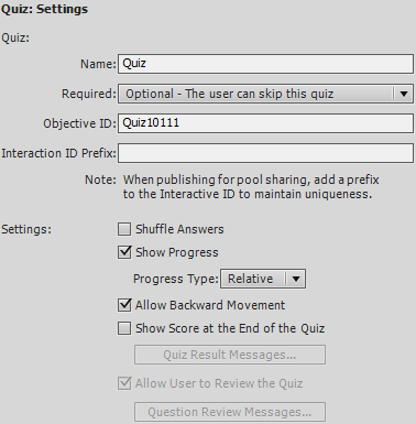

I did have the self-paced learning option checked, so I unchecked it. I did not have "user must past quiz" as required (it's set as optional). I tried adding an interactive button to the first slide and giving it a score. But after re-publishing, I still can only go back to the first slide (not any previously viewed slide) if I stop and re-enter the course. Here are the settings:
Quiz Reporting:
Manifest:
LMS Customization:
Quiz Settings:
Quiz Pass/Fail:
Settings for the interactive object on the first slide:
Settings for the "quiz" on the last slide:

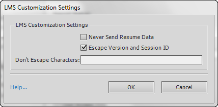

Jul 19, 2014 Jul 19, 2014
Look in LMS  Reporting > LMS Advanced Settings (button at the bottom of the dialog).  There's a check box for Never Send Resume Data.  If that box is UNCHECKED then Resume Data Bookmarking is turned on. (Yes it's counter-intuitive GUI design at its best, we know.)
