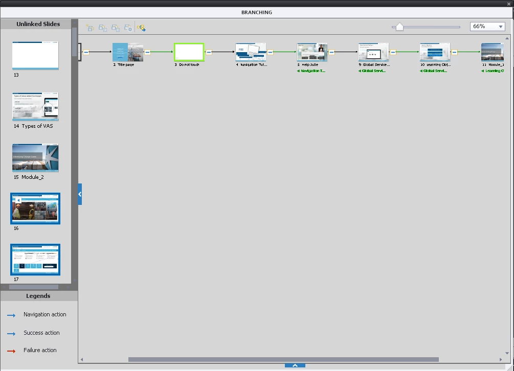

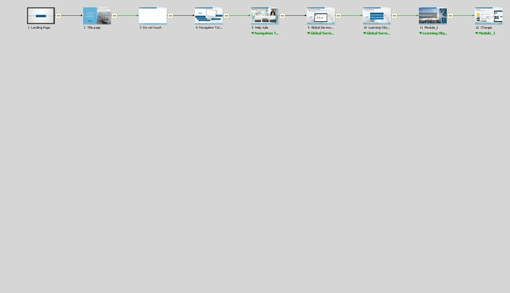

I tried to view the branching view to understand the linkage of the slides but the view does not show the complete navigation for all the slides.
I have around 50 slides, slides 6 to 8 i have hidden. Slides 13 to rest appears as unlinked although all of them have their previous and next buttons set to move back and ahead one slide.

Branching view panel is almost usless if you use custom navigation.
Branch aware and not allowing Backwards movement in Quiz could have been the cause, but that is fine. Do you perhaps have Pretest slides?
