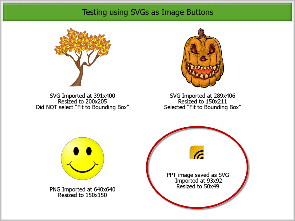

Everything looked fine as I was working in Cp and when I previewed in HTML5. What I saw in the output was not what I expected. (I have screenshots below.)
I researched and played around with images and settings and I think the cause of what I am seeing might have to do with saving images as SVGs, but I'm still not sure how that is causing the issues I'm experiencing or how to resolve it. Sidenote - I really don't have any experience with using or creating SVGs.

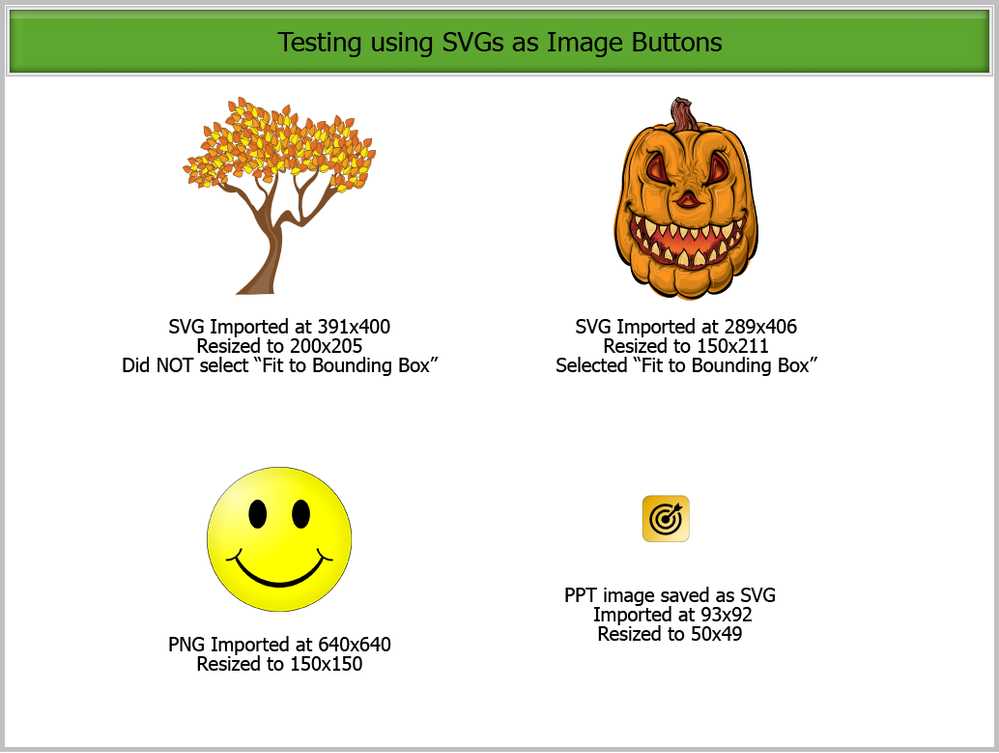

This is what I'm seeing as I work in Captivate: All Good
(Note - The resizing happened within Captivate in the Properties panel)
This is what I see when I preview in HTML5: All Good
This is what I see when I publish the project:
See button in bottom right corner. It's like it wants to display at the original size, but it's only showing the amount of the resize. I've tried selecting and deselecting the option of "Fit to Bounding Box" and get the same result.
Does anyone know why this is happening or how to resolve it?

Sorry but I edited the title because it has wrong terminology: Image buttons are on of the three old-style buttons, they never can be filled with SVGs. Only in 11.5 is it possible to use SVGs directly as buttons.
Strange images to be used as buttons. I suspect the workflow, MS has never been very good with handling images. Save the image as a bitmap image and convert it to a SVG with a better application. I always use Illustrator for that purpose.
I don't know how you resized the SVG in Captiv
